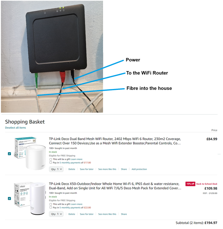

Based on this thread, I think I want this set up.
At the moment we have Fibre to a box just under my desk which links to a WiFi Router. The signal is okay around most the house but not great in the kitchen extension or conservatory (through outside walls). There is bugger all in the detached garage about 10M away.
I mostly want to get wifi in the garage which is a dusty environment, hence one of the routers being 'outdoor spec', but better wifi elsewhere would be good.
Please confirm I am ordering the correct 2 items to achieve this before I blow £200 on the wrong thing.
*My Wife is great upstairs except possibly for cleaning the slightly dusty skirting boards under my desk.
Posted : 06/09/2024 3:08 pm
Posts: 1140
Don't think you want either of those things actually. Reckon this or something similar with one of them plugged directly into that black box of yours and the other two plugged in about the house should do the trick.
EDIT: sorry didn't clock the dusty garage thing, either way I reckon you could have one garage adjacent and still get good signal in there. Or if you do end up having on in the garage they're solid state boxes, no fans or anything so as long as it's not being rained on I'm sure it'd be fine.
Posted : 06/09/2024 3:12 pm
Posts: 8613
Unless you're on Gigabit fibre there's no real need to pay the premium for WiFi 6/7 kit (but fair enough if you want to long-term future proof). How far is the garage from the house (where the router will be) and how many walls? If there's a few walls or it's a long distance the one in the garage might not connect to the one in the house (so you might need another in the house in between and by a window/door leading to the garage. But no harm to try with just those 2 units first as long as you have the budget for buying a 3rd one later if the signal is too weak for them to connect reliably. As for the outdoor unit version given it's not a big premium over a standard unit it's probably worth it although probably not strictly necessary for your average garage levels of dust.
Posted : 06/09/2024 3:25 pm

Posts: 13369
I have ordered what SoundNinjaUK recommended and pick them up tomorrow. If I am on line tomorrow I will tell you if they worked.

Posts: 13369
[i]Well now I feel the weight of responsibility.[/i] - You are.
I am planning to have one in the office, one in the conservatory nearest to the garage and then one in the garage, probably in a plasit bag to save it from the worst of the dust. There is a lot of dust right now, see https://singletrackmag.com/forum/topic/are-you-bored-enough-to-watch-project-ds911/page/4/
Posted : 06/09/2024 10:23 pm

Posts: 13369
It works!
A bit of a faff getting the garage unit connected with line of site to the conservatory but i managed. You can just see the top of the other unit through the window.
https://photos.app.goo.gl/cjoEfouyWiF5JowKA
