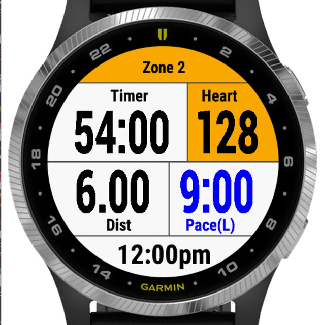

I want a running screen for my fenix 5 plus that shows
Pace
Distance
Time
With hr zone displayed as a colour so quick glance sees I'm in green or Amber
Doable?

Yes. Use the four-field option that has a wide bottom segment, and for the heart rate option, scroll down to "graphical fields" and choose heart rate. I don't think the colour of the number changes. but the zone graph is pretty easy to read.

This is what you want isn't it?
https://apps.garmin.com/apps/cdcaa909-f11d-4f4c-84f6-4aed341362e6?tid=1

Run zone BPM is my favourite for this. Nice clear display
You can tweak the fields a little bit and you can set custom colours for each zone

Is that all available on the 5 plus? I know I can do it on my 7 pro but don’t remember being able to do it on my old 5.

Runzone BPM will work fine on the Fenix 5, it even works on the Fenix 3HR apparently
https://apps.garmin.com/en-US/apps/140d3379-ce7d-4851-803b-f71f7967717e

Sorted
Thanks
