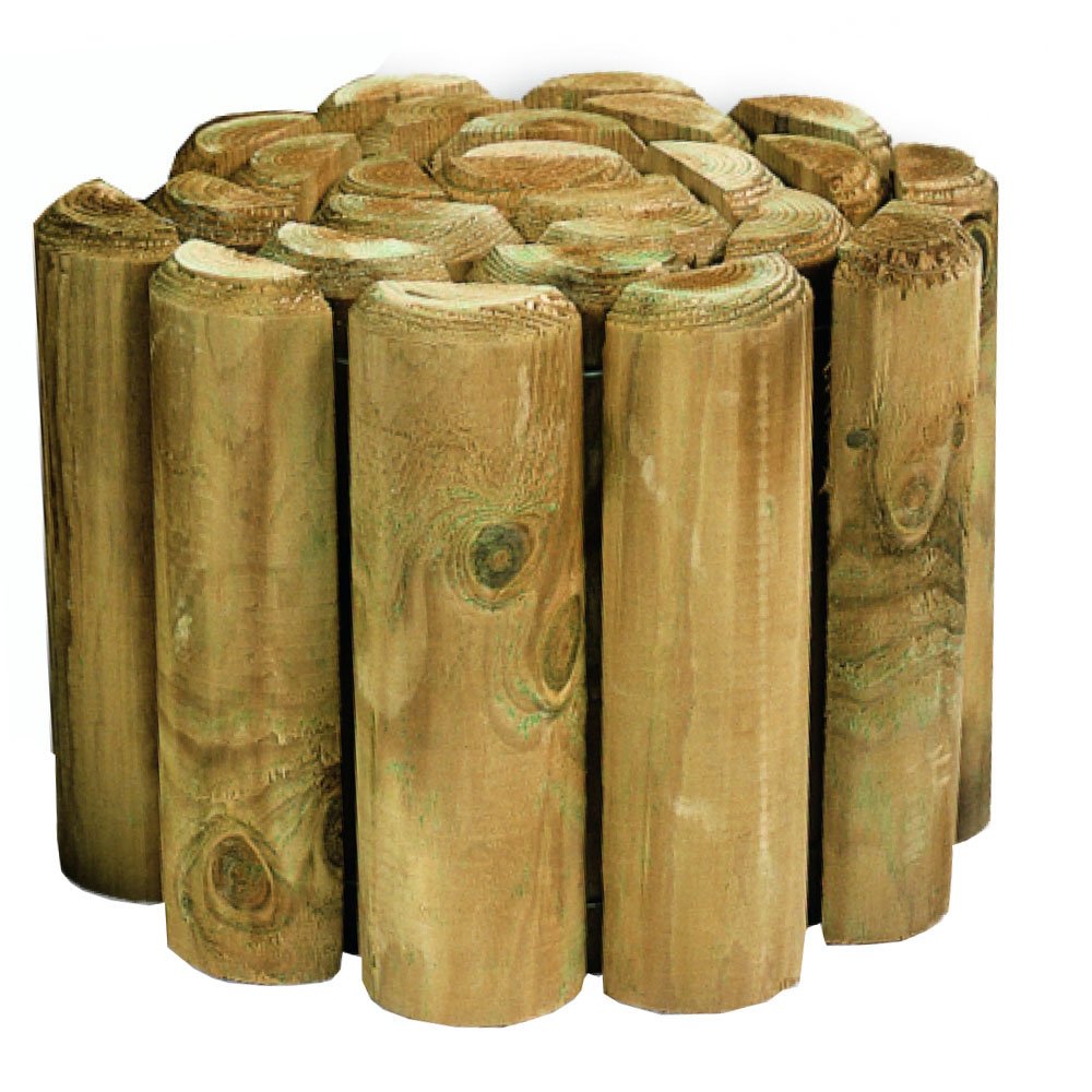

Is this actually a good idea? 18" logs.
It's cheap and I like the idea of wavy patterns (aware it will make any lawn mowing a bit of a 'mare), but am a bit dubious of how the hell I'd get it to stay upright (chuckle).
I can afford to lose 6" (s****) in the ground, leaving me 12" (guffaw) as a retainer, but something just makes me think that the physics don't add up and it'll end up on the piss once filled full of soil, perennials and ex-girlfriends.
Anyone got this with success stories? Did you stake it somehow?

Hateful stuff. You'll get more tufty bits around the edge than an East Europeans bikini, and it's usually on the slant one way or the other.

looked nasty after first year - as above, slanted all over and didn't hold a border (slope) or the lawn back well - got rid and redesigned around (halved) sleepers, oh sorry you wanted success stories...

we had some in ours - I'm ripping it out as and when I can be arsed
it's a bit kack (yes slanty, yes tufty but also somehow interspersed with bald patches) and my wife thinks it's ugly

Will add to the hate by saying they will rot in no time

There was some in our garden when we bought the place. They stood up ok but as above.... they rot pretty quickly, weeds grow through them and they are generally a bit rubbish.
All now replaced thankfully.

Put it along the edge of a winding gravel path through rough grass, flat side to the path. Worked to keep the stones in, survived strimming, but rotted out in five years. Now someone else's problem, and I wouldn't bother again.

Difficult to install, a nightmare to mow around (our garden takes 10 mins to mow and 50 mins to trim ****ing edges), won't stay straight, and rot in a couple of years.
We tried a different approach second time - made long planks with stakes on to hammer in, cut to the right shapes and angles. Painted the stakes and the backs with tar paint to encourage longevity.
One still doesn't sit straight though.

Use plastic edging or decent wood. Those log rolls are rank. If you aren't edging lawn against stone chips then you don't need any edging, just a neat lawn edge.

As said above, don't do it! Pain in the arse with grass growing through, staying upright and the things rotting after a while.

Cheers all! These are tanalised so should have given a few years use, and were needed to create a raised bed. Seemed a cheap way of doing it.
Warnings heeded though, will try to research alternatives that are still cheap-ish and look ok.

I installed a load this autumn, very hard to get vertical but I'm not bothered by the slant. I put it in mainly to keep the wood chippings in the flower beds as the cats keep raking them onto the lawn every time they go to the loo. It definitely fixed that problem.
So were ours - lasted maybe 3-4 years.

I did ours last year. The installation method I adopted was thus
1) soaked the base of the wood in old engine oil for a month or two
2) membrane then pebbled the beds, leave an overlap of membrane (see number 4)
3) dug trench for log roll
4) put in membrane overlap including the front of logs
5) back fill and pack in log rol
6) trim excess membrane
No weeds so far should last a good few years still looks good and solid
Ok it does take 10 mins longer to strip to the log rolls but saves a ton of time weeding and keeping the lawn edged
