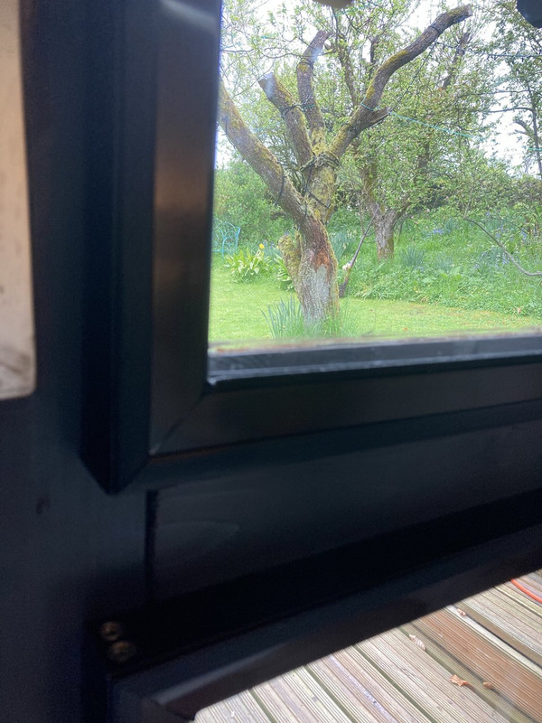

Posts: 1846
I did that a couple of years ago and it makes a big difference. We do get some condensation in the bottom inch of the window but it soon clears.
I have just taken a bad photo of the door below to show that we kept quite close to each pane. These are fully sealed rather than removable panes. There are very slight air gaps in the corner joints
Window
Edit: the windows stay nice and clean on the inside
Posted : 03/05/2022 1:27 pm
Posts: 2880
Perfect - thanks JP!
Just to check, you’ve used two separate glass panes and sealed both into place, as against a sealed double glazed unit fixed in place?
Posted : 03/05/2022 1:44 pm
Posts: 1846
Correct. We got the glass ordered to size and then cut lengths of extruded aluminium hence the small air gaps but I think they help. We decided the door would not work well with the weight of double glazing.
Better picture
Win
They are easy to unscrew if needed as the screws are behind the rubber beading
Posted : 03/05/2022 1:50 pm
