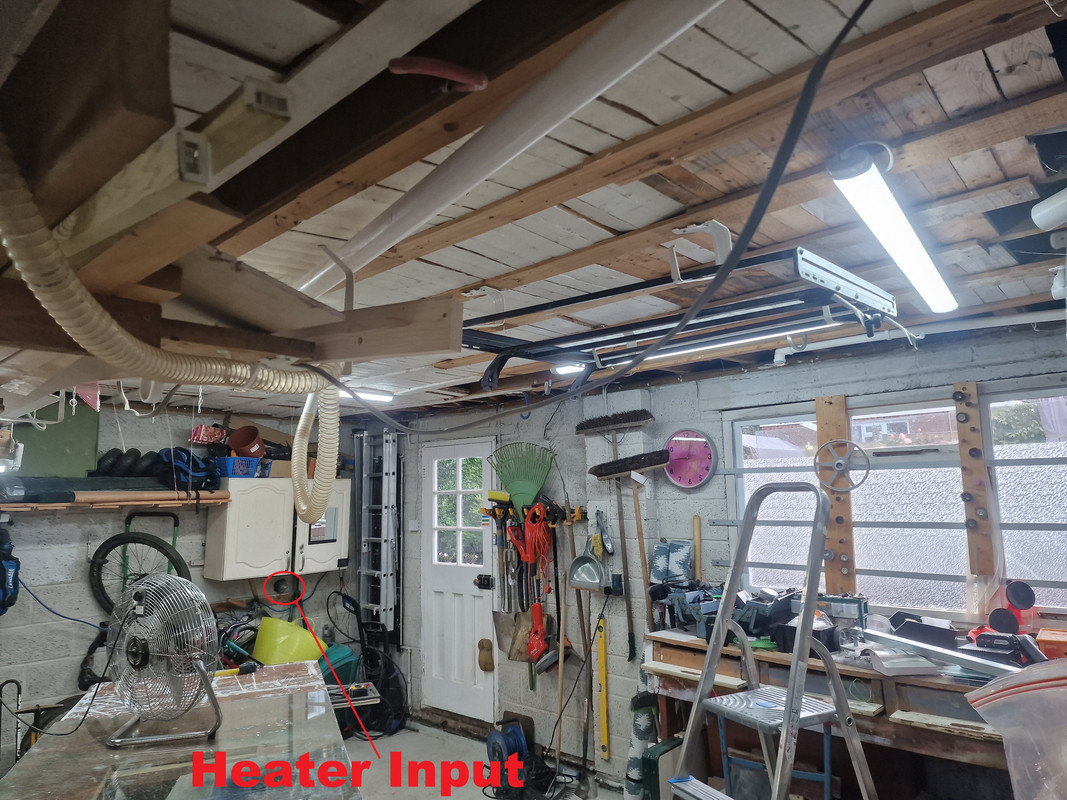

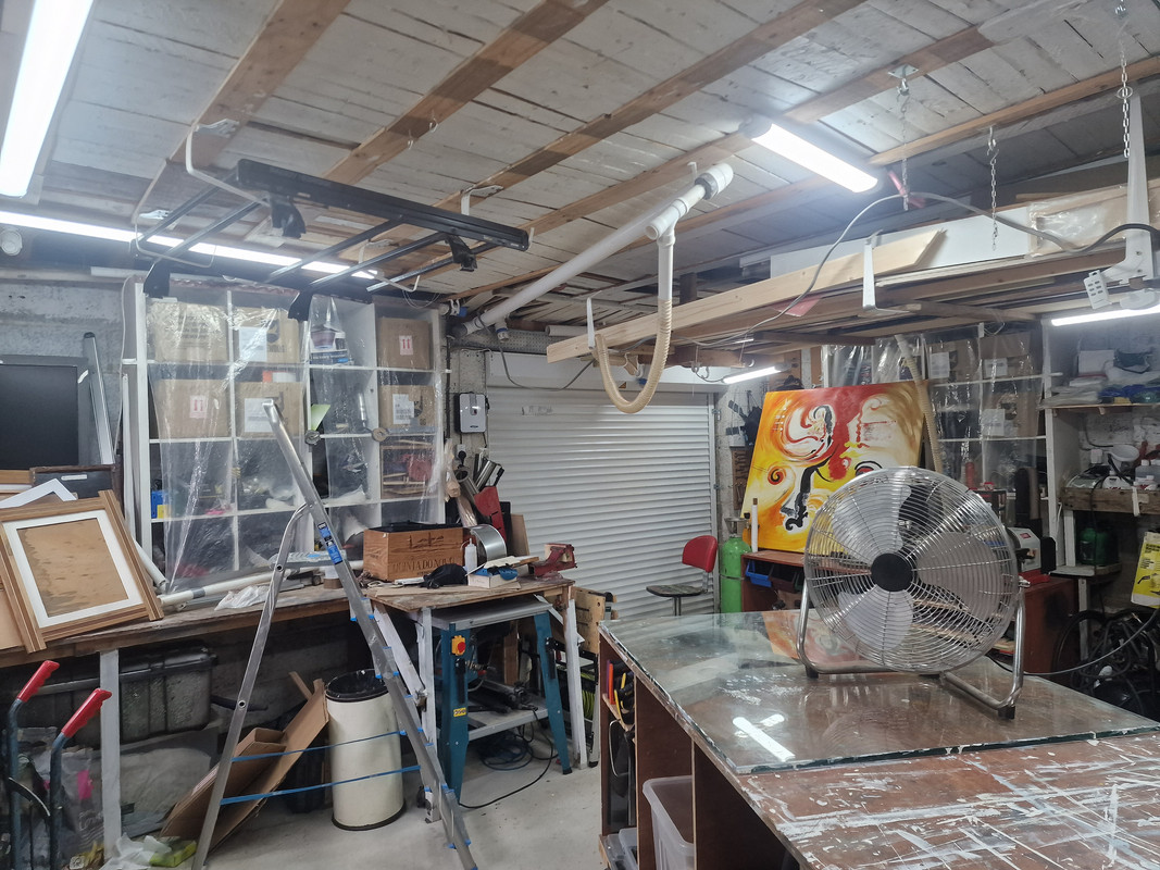

View from the side door which is the main one used. You can see the new(ish) plastic roller door that seems to fit smoothly without air leaking in around the sides or bottom as the old one did.
This is the view from the big door which shows the dingle glazed window and small door. You can also see the pipe where hot air is pumped in by the diesel heater. This is clean air without any diesel fumes as basically it just sucks fresh air around the engine where it heats up and this heated air is pumped in.

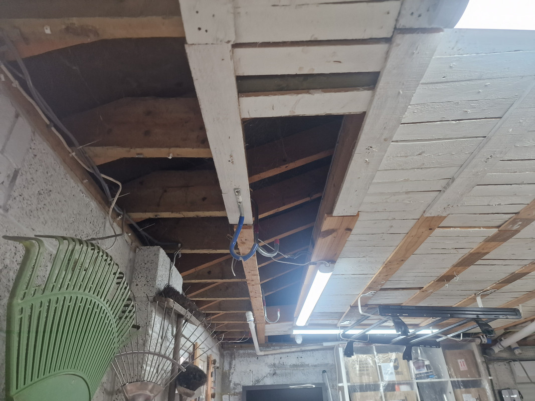

This shows the rafters. The existing white wood ceiling was put in a few years ago to reduce drafts but mostly to reflect light and make the garage less of a black hole. I plan to re-use some of the short white planks to hold up the polystyrene. Basically put a long screw thought the plank, the insulation board and into the rafters. The short plank with then act like a really big washer to support the polystyrene without too much localised pressure.

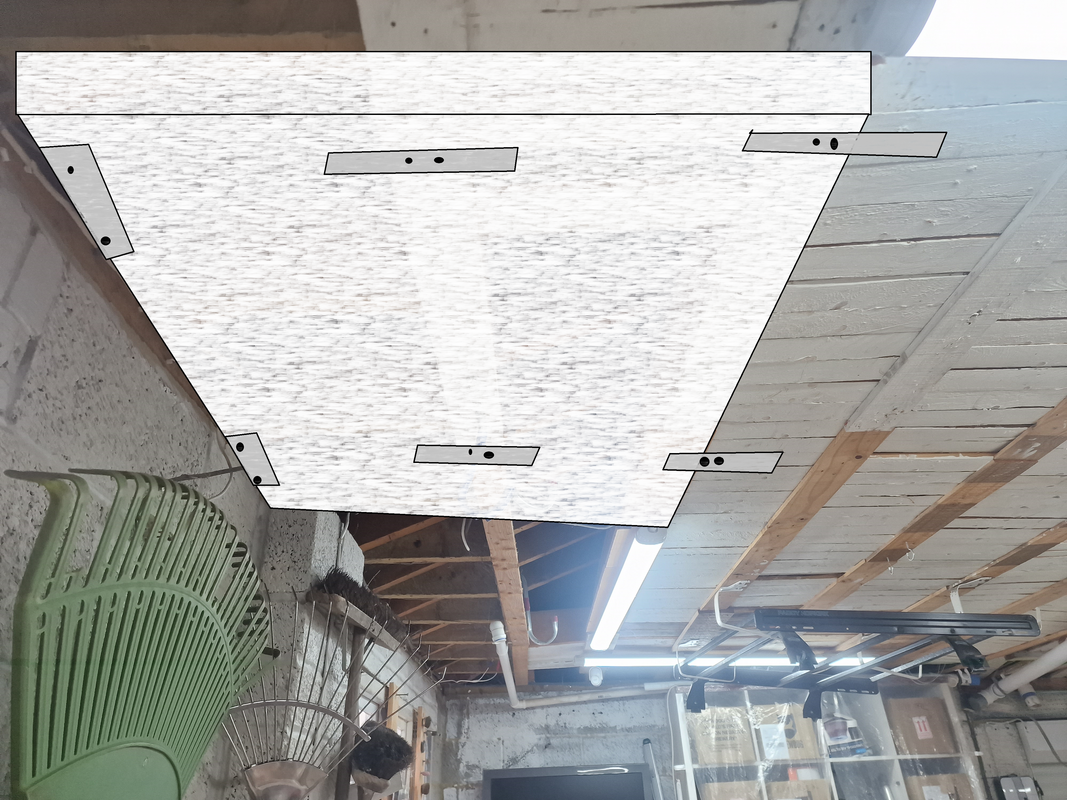

I was thinking insulation board BELOW the rafters. I can lose 50mm of height for the easy of just banging the polystyrene up.
Possibly not the greatest design diagram but hopefully understandable. The boards rest against the rafters. There are then small planks screwed through the insulation and into the rafters to hold them in place. If I need tpo remove a board in the future I unscrew the planks in the middle and then loosen and rotate the ones at the edge keeping it close to the neighbouring board.
Seems the quickest and easiest way. I just need to mark up where the rafters are and use some of my 100mm screws.
