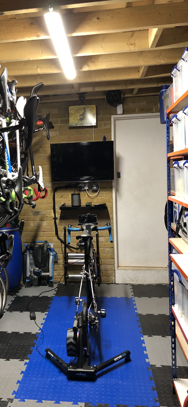

But the nice ones are pricey (c £450 to do the whole floor)
Did this. Was worth every penny. Transformed the garage. AND I used 8 blue tiles for the KICKR 😉 Big Dug tiles. An epoxy floor will still be cold.

Do you have a photo @TiRed? I am in the same place as the OP, been going round in circles for 2yrs on whether to upgrade floor and insulate walls.
