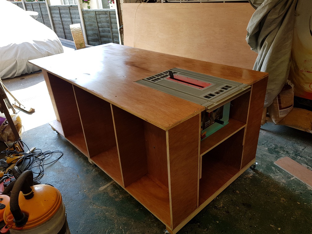

I painted mine 10+ years ago with some green garage floor paint which is beginning to wear. I was debating repainting of these floor tiles.
With the floor tiles can things like my rolling work bench still roll or will they casters sink into the tiles?
It has been loaded up and put on weight since this photo but is 120x240 and home to table saw and loads of other stuff. I can currently roll it from one side of the garage to the other depending on where I need the space
On my tiles, I reckon that'd sink in a little way and leave an imprint for a day or two after you move it. I've never had a dint that didn't eventually sort itself out. It depends how heavy that workbench is but I reckon you'd be able to roll it. It just might leave loads of semi-permanent dents if you move it often.

I have the Halfords ones linked above, and until recently had a mobile workbench on chunky castors, but it was hard work moving it around on the squishy floor, so have recently re-designed the layout with a fixed workbench. I also have a kit car in the garage, it does now have permanent depressions where the 4 wheels sit, but otherwise is as good as it was when I fitted it ~10yrs ago. Makes it much more pleasant working in there!
I've got duratile something or other. They are pretty hard. My big rolling tool chest still rolls around.
