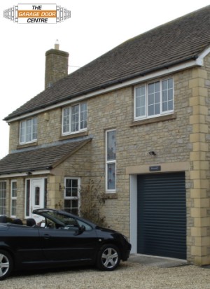

We had a secueroglide roller door fitted recently - about 1600 quid.
Secure - insulated slats - roller on inside of garage walls - lots more available room now compared to the up-and-over door before.
http://www.thegaragedoorcentre.co.uk/seceurogliderollershuttergaragedoorsoverview.php
same color as this one :
Posted : 25/01/2015 8:05 pm
