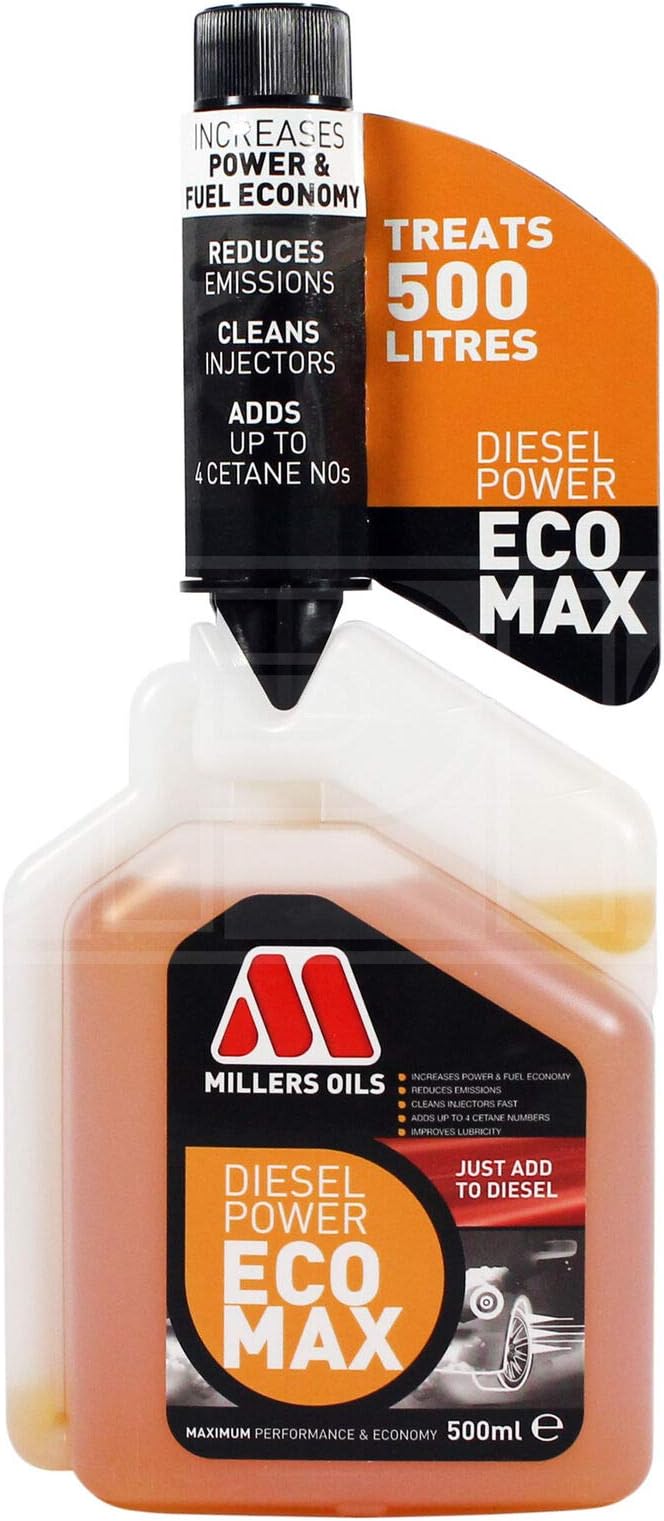

I use this from Toolstation,
https://www.toolstation.com/fuel-treatment/p75916
EMpty into tank of diesel, warm up engine and go to a quiet straight road, accelerate hard in 2 or third and watch the sky turn black behind you, do 50 miles and repeat, the harsh aceleration, engine will run quiet and smoot as well as improved acceleration use every few thousand miles.
Have used Redex, for diesels and doesnt do much.
Posted : 25/06/2021 9:14 pm
