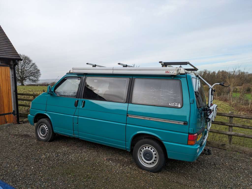

Some friends of ours have left their VW Campervan on our drive whilst they go travelling.  It's been there since mid December. It's a 30 year old van. I'm not sure what model except it's 1994 manufacture and 1896cc, see pic below.  They already knew the vehicle battery was on it's last legs so I've been trickle charging it with a battery optimiser and occasionally starting it up.  Today I thought I would move it a little to avoid any tyre flat spots and realised they'd left the handbrake on when they parked it up - unsurprisingly it's siezed on!
I knew this would be an issue as we live in an exposed spot out in the sticks and have had this happen before on our cars. We now know to leave them parked in gear and never leave the handbrake on, but I forgot to mention this to our friends!
Are there any easy DIY ways to free it? I've tried applying and releasing it and gently rocking it in forward and reverse but no joy.  It's only seized on one wheel, the rear left.  I haven't had chance to look underneath it yet to see if I can access the cable.

Tap the rear wheel nuts with a hammer (enthusiastically) can give rhe drum brake the jolt it needs to release

More aggression! Big hammer and hit it bit. Try and drive it and it should break free. Mid December is not that long so its unlikely to be very stuck.

Had this exact issue with a friend's car the other day.
I tried this, and got increasingly un-gentle until it popped free.
The problem with being on the gravel is the stuck wheel will just slide and plow a furrow in your drive
Posted : 04/01/2024 12:40 pm
Posts: 5354
Yep!  Now going back out with a big tapometer
Posted : 04/01/2024 12:44 pm
Posts: 5354
Thank you. Big **** off hammer, lots of enthusiasm.  It worked like a charm. Now parked up in gear and hand brake OFF!

Wish I'd known I could have used a hammer when this happened to my partners Seat. Ended up taking the bloody wheel and drum brake apart in the road. Although my hammer wielding skills and the alloy wheel could have been a show stopper there.
Just make sure you haven't parked it on a hill... Ask me ho I know...
