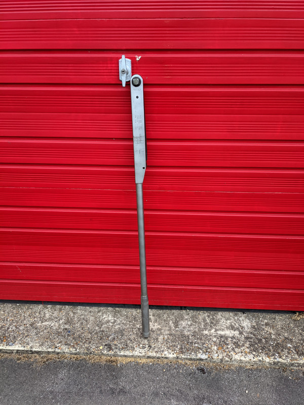

Posts: 1070
500nm, that’s mental. Think my 1/2″ torque wrench only goes up to 210nm. Highest I’ve used is 200nm for brake calipers
Yep, it is quite high. 1/2" drive doesn:t cut it. You need one of these and they won't work below 200Nm!
