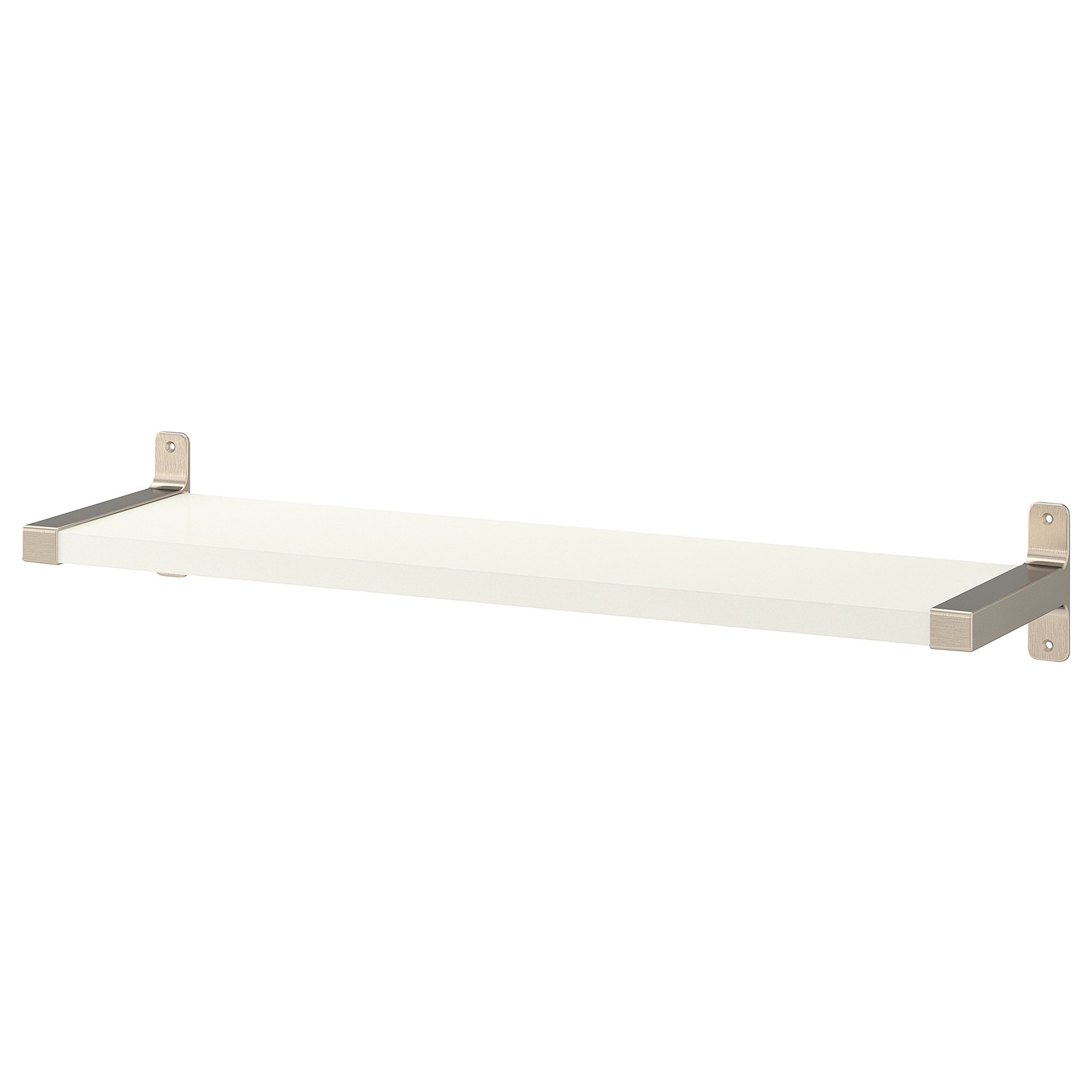

Alternatively, bin the BQ ones and go to IKEA for these, had 7 up in the kitchen holding a multitude of cookbooks since 2010.
