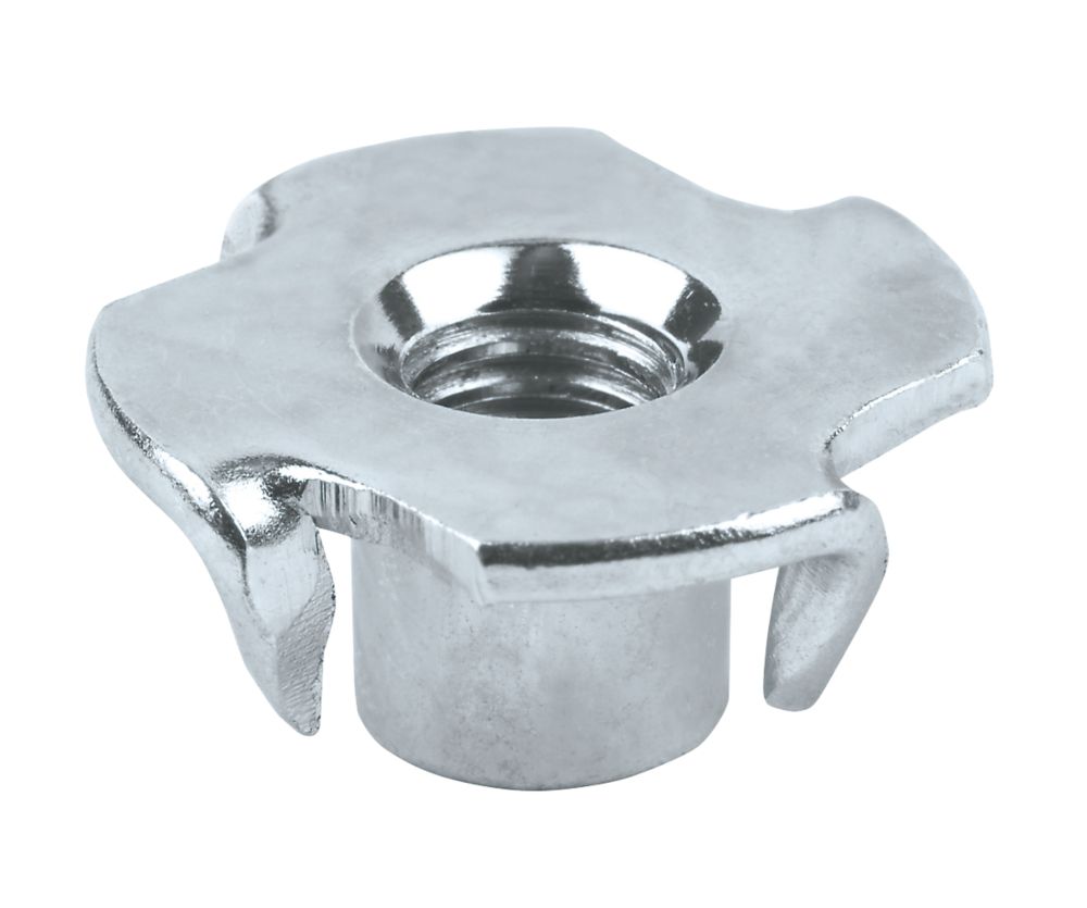

I would use pronged tee nuts.
[img] http://s7g3.scene7.com/is/image/ae235?$p$&layer=0&size=281,281&layer=1&size=281,281&src=ae235/79359_P [/img]
Ive Fitted hundreds of TVs using these to similar wooden materials.
