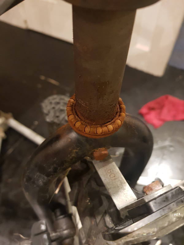

A pal asked me to have a look at his bike for him.  I think he had stored it in the sea.  I have never seen such a rusty mess and this guy is an engineer and a museum level conservator

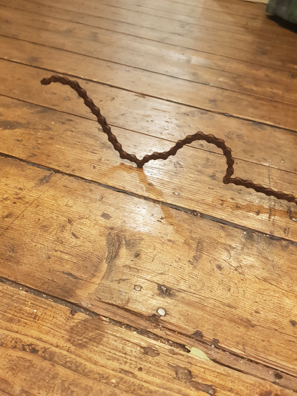

Chain was so rusty a chain tool would not split it and i had to break into 3 pieces to get it off

mechs and shifters have freed off ( they were completely seized).  wheels are Okish and BB is fine.  Cables totally seized.  cantis all seized as well but they have been stripped and cleaned and are ok
Classic Plutoline 😉

To be fair, headsets are often un-sealed at the low end and they can get like that pretty quickly through just riding the bike.  My first MTB, (a Kona!) had such a headset, it had smaller bearings than the one pictured and due to my riding around actual muddy trails all the time it looked worse.
The chain is unforgivable of course!

Done!  Credit to shimano 'cos even tho everything was totally seized even the shifters it all freed off after a good soak in gt85.  new balls in the headset, new cables and chain and it all works - well sort of :-).  Everything is a bit rumbly but its good enough to see if he uses it and if he does it can get a bit more time and money spent on it.
