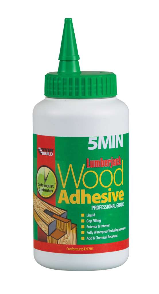

Posts: 17803
I've used this Gorilla-alike glue a fair bit.  You get it from Toolstation or Screwfix.
71alJnSyfoL
It's very good and cheaper than Gorilla.
You get a 5 minute or 30 minute set version. As mentioned above, you need to moisten the area which is what makes the glue do it's thing.

Just to warn about the gel PU adhesive, it will continue coming out the nozzle for several minutes even with the pressure released on the gun...don't lay the gun down anywhere you're going to regret later! I'm no longer a fan of the Gorilla glues, the PU takes ages to set and excess goes really hard, the PVA goes lumpy in the bottle at moderately low temperatures.
