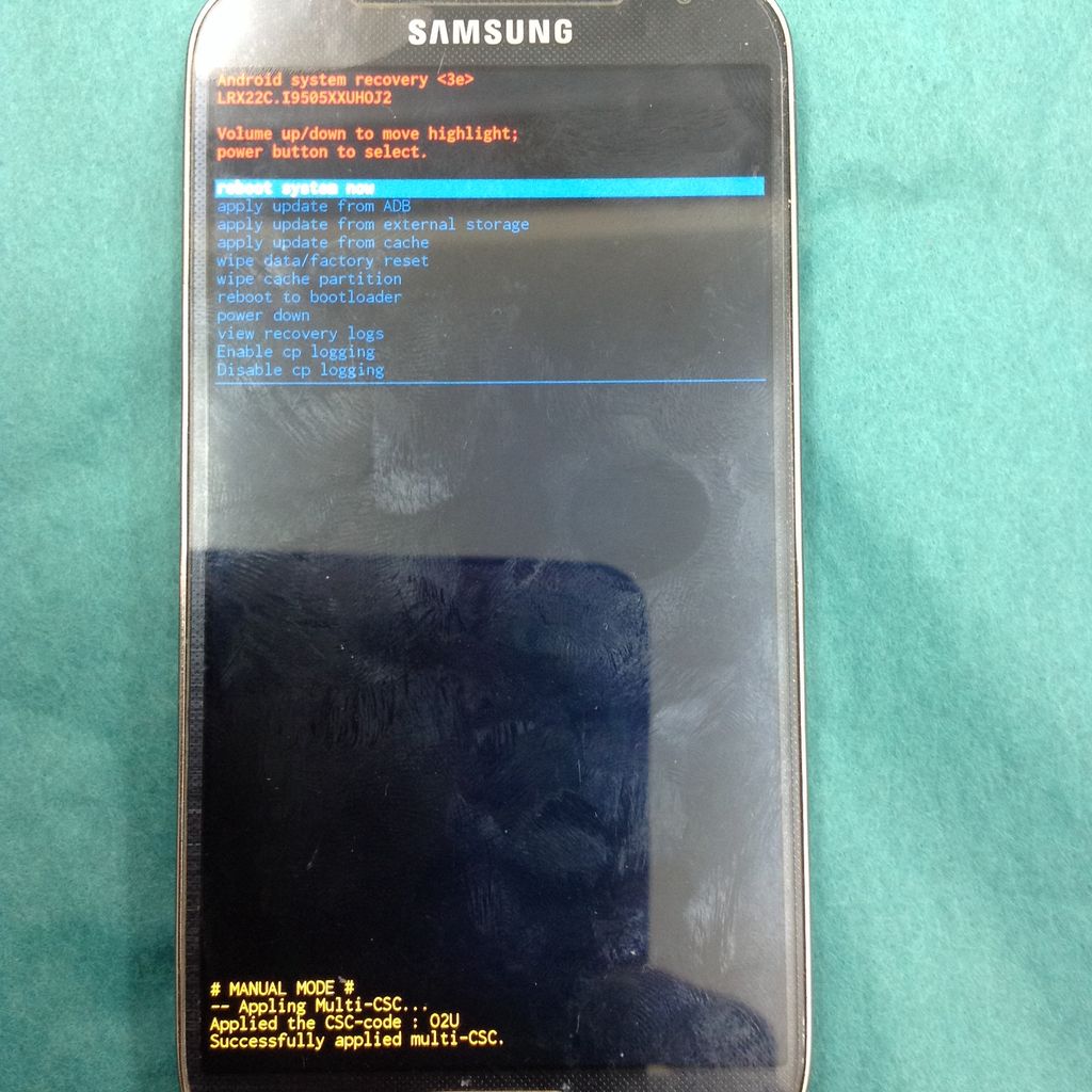

My galaxy s4 started using a lot of its battery yesterday.
So to fix it I thought I would turn it off and back on.
This is what I got when I turned it back on.
I pressed reboot now and it just turns off and goes back to this screen . What else can I try?

I'd probably try the wipe data/factory reset option next

Take the battery out and then turn back on (or use the Power Down option)
Looks like you've caught a combination of buttons to enter a firmware mode (managed to do this on my Nexus 10 the other day).

Volume Down key is stuck.

Actually I did drop it and the volume up key went a bit sticky. Have tried freeing it up but still no joy.

Brute force and a screwdriver has sorted it.
