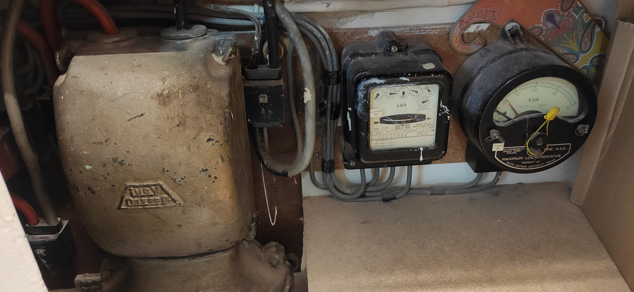

Whenever they've sent someone to fit a digital meter the man looks at it and says he can't do it.
Are they just being lazy ? Can they fit another meter after the old one just so that we can accurately measure our useage .null

Why do you think that one isn't accurate?
Posted : 14/07/2021 4:53 pm
They're only designed for 10 year life span, however doesn't mean it's significantly out. I did test our old analogue one by turning everything off bar one 100W light bulb and timing the spinning disc. Was spot on.
As for getting a new one, did he say why he can't fit a new one?
Posted : 14/07/2021 4:57 pm

Thats a beauty. Don't let them take that away!
Ask your supplier or ask your mates for a clamp on energy monitor, I think Ive been sent about 3 over the years and thy went in the bin when I moved house.

Just seen the photo +1 for not letting them take that away.....that'll most likely spin backwards if you get some micro generation on the go netting you retail price equivalent for your exports Vs wholesale (1/4ish of retail )

Induction clamp on meter will tell you how much you're using, just switch a few things on and off to figure out what's using all the power.

Meter Changers are not trained to a very high standard, so something out of the ordinary, like the cast iron cut out you have, is beyond their skill set.
It is the most dangerous installation to change, as it is common for them to fall apart when taken apart, due to age, and they are surrounded by metal, rather then bakelite/plastic. The meter changing wouldnt be a problem, it is taking the fuse out of the cut out that is the problem.
He/you should inform the Network Operator (Western Power/SSE/Energica etc) to come and change the cut out, the meter changer can then safely change the meter.
