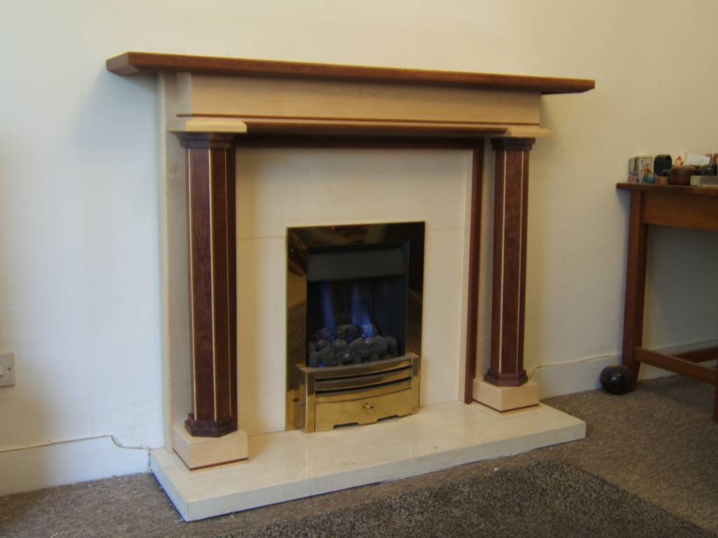

Nothing beats a lovely mantelpiece.
Here's one I made earlier 🙂
