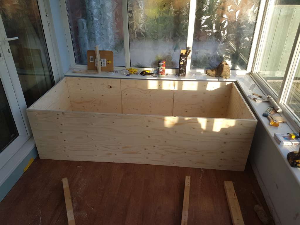

Finished building the box earlier. Needs dividers and a lid. I knew it was big, but now I can see it, it's bloody massive (2100x900x600 to be precise.
20231111_150223

I think considering colour, cost, and ease of application, a water-based varnish might be the way to go.
How well will that seal the raw edges of softwood ply? There's the odd void that I will probably fill with epoxy - will it play nicely enough with that?
Should do it pretty well. Sand them well first with a flat block and they should be good after a couple of coats or so.
