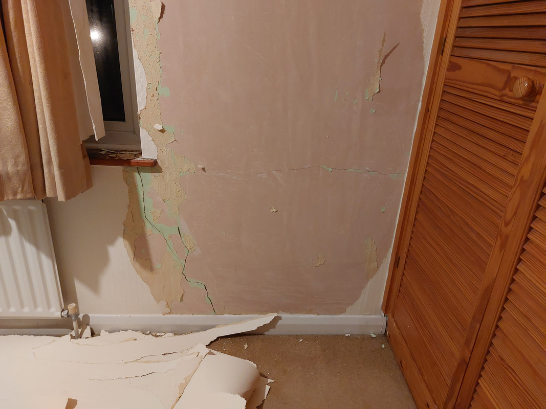

Along similar lines... how big before a crack needs some proper looking at!?
Just pulled off the wallpaper in my new house and saw this (along with something less significant on the other side of the window).
Wall crack
Current thinking is to just filler it and see how long til it comes back.
Posted : 17/03/2022 10:26 pm
Posts: 5164
We have the same in our house, usual remedy is to break it open a little more to check potential issues and damage behind, see if the plaster is secure, widen it, sand down then apply new plaster, then sand it again and paint.
You really want to see what the damage is underneath though, reality is when replastering, it doesn't matter if it's a 10mm line or a 100mm line you're refilling, they're not really much more difficult.
Posted : 17/03/2022 10:31 pm

I've had good results with stretchy ceiling paint that's designed to allow small cracks to move without cracking the paint
Posted : 17/03/2022 10:45 pm
Posts: 1503
I would definitely try the mesh tape and Easifil route before anything else.
Posted : 17/03/2022 11:25 pm

Was the paper torn (before you pulled it off)?
Is there green paint inside the edges of the crack?
Those checks will suggest how recently the crack appeared and how far the crack spread. Old minor cracking is fairly normal around openings, change is a bigger worry, so if you're not sure get a proper opinion
Posted : 18/03/2022 3:35 am
Chase it out and pop some mesh in, then replaster the wall. I had a persistent one and this worked a treat.
https://www.wickes.co.uk/Wickes-Galvanised-Steel-Reinforcing-Mesh---65mm-x-20m/p/240331
Posted : 18/03/2022 7:31 am

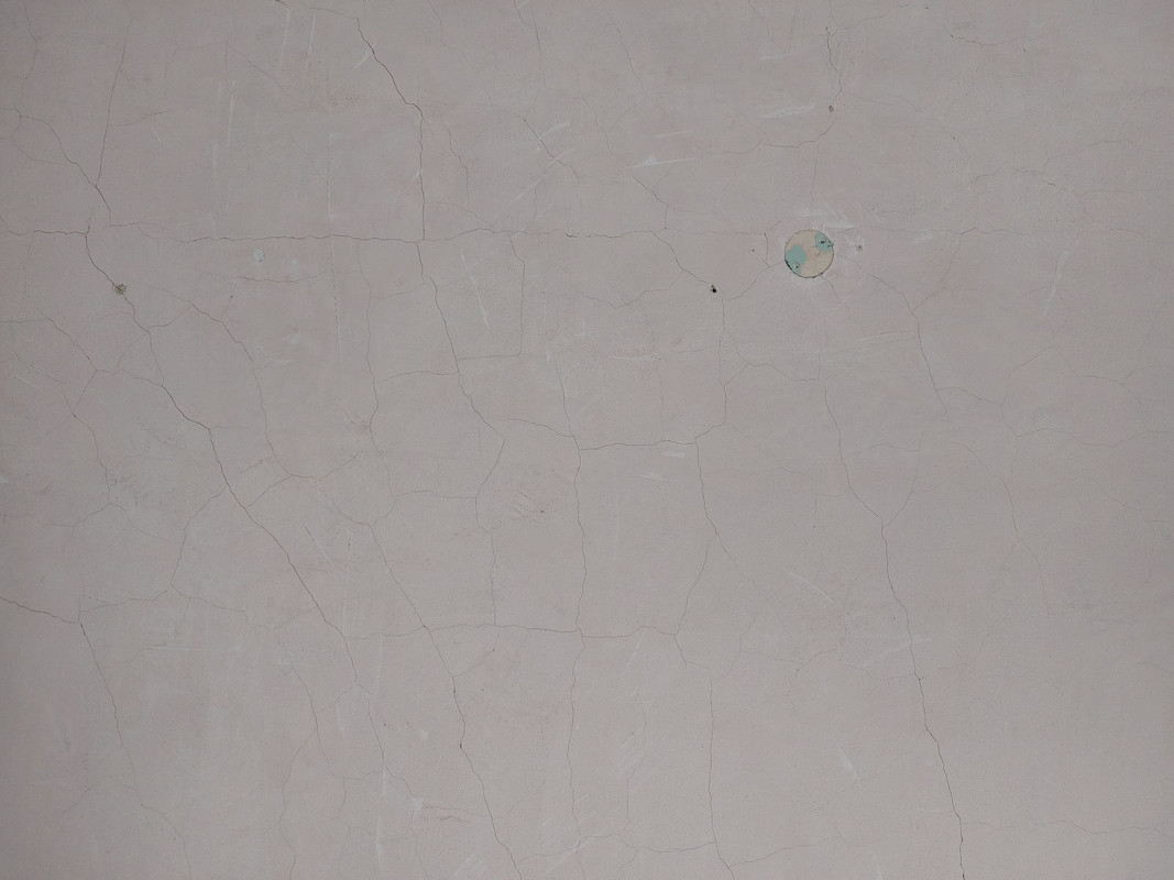

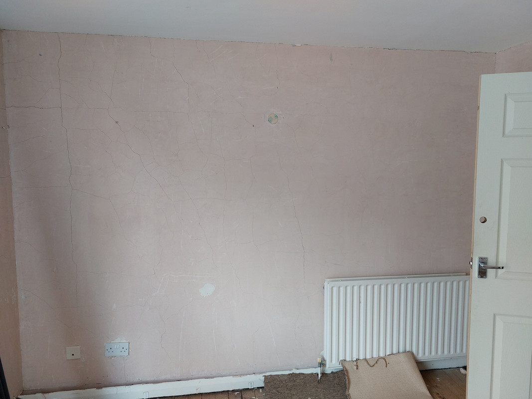

Any idea what might cause cracks like this? And how likely would they be to return through a fresh skim?
https://i.postimg.cc/vB9XtqXt/20220417-183222.jpg
https://i.postimg.cc/mrPmt2Hq/20220417-183213.jpg
All 4 walls in this room are covered in small cracks like this - giving a dried out desert pattern. The walls were previously papered then painted. The photo from my previous post is the room directly above, which doesn't show anything similar. I'm guessing that this is some poorly applied plaster or it's been damaged by wallpaper stripper.
The first plasterer seemed happy to give it a fresh skim. 2nd plasterer was adamant that the cracks would reshow (which surely depends what caused them in the first place, no?) so recommended dot and dab reboarding over the top - which I'd rather avoid if possible (he also offered meshing all walls and plastering, as a more expensive alternative).
Posted : 17/04/2022 10:17 pm
Posts: 6071
It looks like a skim on top of a previously painted surface. The pattern looks too big for "normal" crazing, which is often the skim drying too quickly. I doubt that vertical crack above the TV aerial socket is crazing, for example
Have a poke at a few areas to see if it's loose; get a third opinion and go with the majority. My feeling is that it's too much in places to just skim, but I'm looking at a photo
Posted : 18/04/2022 7:41 am

OP you could try raking it out and using a paintable mastic type filler.
https://www.sealantsonline.co.uk/Products/Paintable-mastic-sealants/CCC0140
Posted : 18/04/2022 12:26 pm
Posts: 1432
Good idea timba, but getting a 3rd plasterer to respond and give a quote is proving impossible!
My main concern with dot and dab boarding is having to give extra thought when hanging stuff on the walls. Even if that is just finding some longer screws for everything to sufficiently penetrate the brick layer. We've got a very heavy vertical radiator to mount shortly! Is that something to seriously think about?
Posted : 19/04/2022 8:59 pm
Posts: 6071
Whatever you do will be wasted if the old skim is loose and you have a poor base with larger cracks.
There shouldn't be a problem mounting a radiator if the fixings are correct, longer screws are one option. The more frequent problem is moving everything 20-25mm further out, the radiator pipes will need moving, the electrical sockets will need enough spare cable, etc. Skirtings and architraves will need replacing and possibly even the window sill, etc.
That's why I'd try for a third opinion, maybe a local builder? These are the jobs that they save for a rainy day (literally) or when there's been a delivery mess and they're hanging around
Posted : 20/04/2022 6:32 am
