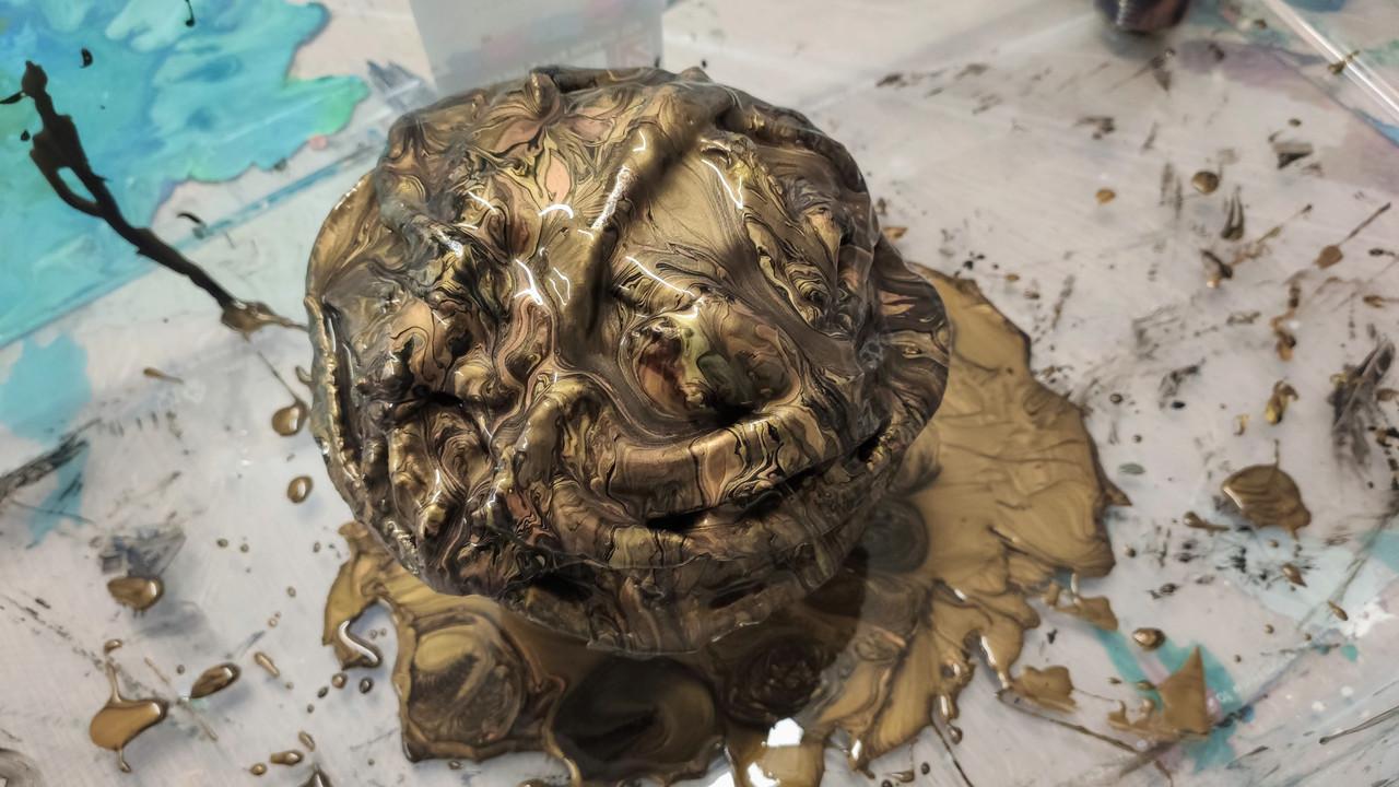

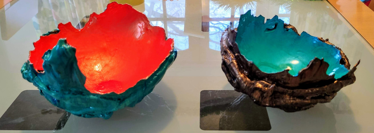

You can add some cloth rags into the final few layers to create 'features' rather than just a round rock. A bit like these bowls but on a bigger scale and obviously you don't need to paint them.
