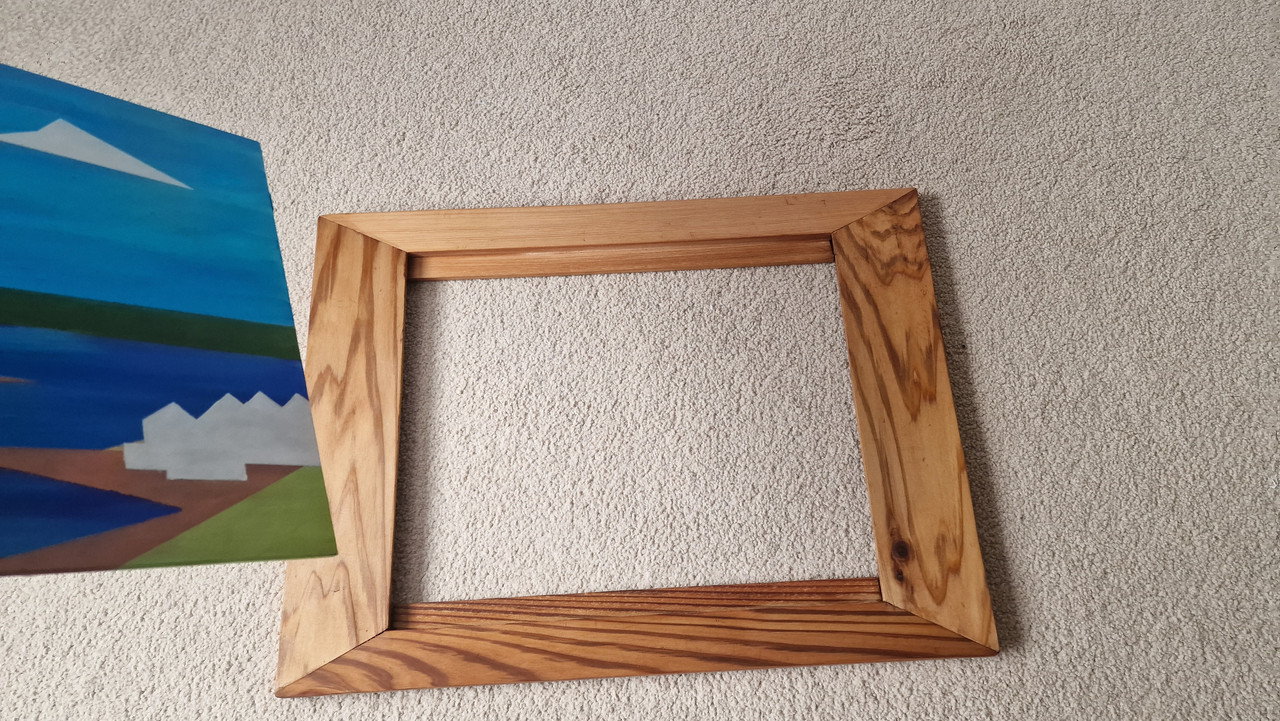

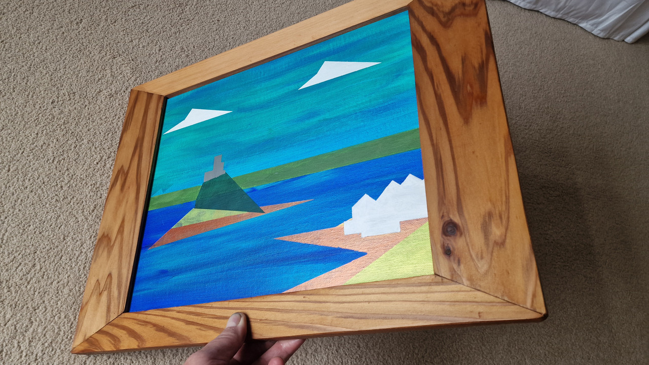

Well, exciting if you want to be able to change the painting in a frame easily.
Here we have a wooden frame and a painting we want to fit into it.

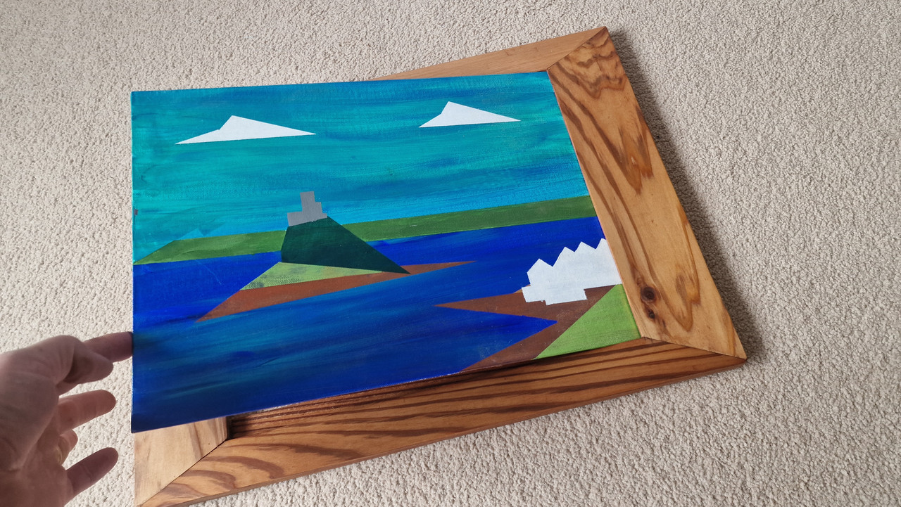

Simply position the painting on the top and bottom support ledge rebated into the frame.
Slide it all the way to the right so that the left edge now sits flat on the support ledge.

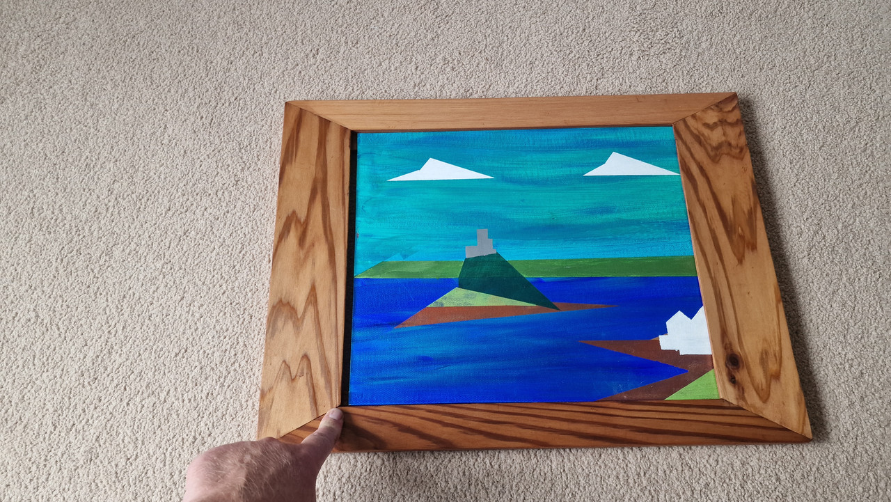

Tilt the frame to the left and tap it so the left edge of the picture slides behind the edge of the frame

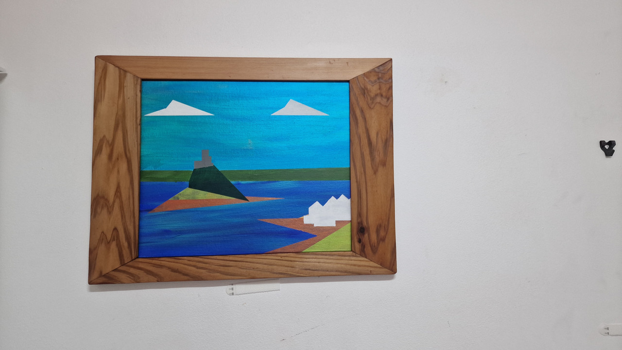

And you can hang the framed picture on the wall
It is a reverse of the process to remove it and slide another painting in its place. Obviously only works for paintings the same size and on the same thickness of board.
Better than the commercial ones clipped in from behind because there are no moving parts to fall off, seize or stop the painting hanging flat. Also this only costs my time to make and I can do different ones for the normal size paintings I do meaning if someone wants a dark frame instead of a light one, I simply slide the paintings out and switch the frames.

Is that white bit on the right a stegosaurus having a drink?
Posted : 03/10/2022 3:47 pm
Posts: 13287
No, it is bowing before the green faced crow in a crown, rising from the water in front of it while the big light blue monster stares down on them through its cloudy white eyes.
IT IS ART MAN!
It is only defined by what your brains sees
Posted : 03/10/2022 3:53 pm
In that case I'll stick with my dinosaur.
I like dinosaurs.
Frame is a neat idea though.

OK - is the empty hook to the right of it also art, perhaps a conceptual piece showing that the art itself transcends any physical representation of the art, so any representation is inherently flawed and the only perfect art is no art at all...

I can see it working well for displaying album sleeves, but I don’t think I have two pictures that are even close to being the same size as one another! In every case I’ve had to find a frame that could accommodate the longest dimension then cut a matt to fit both together. Complicated by wanting to have a bevelled edge on the picture window.
Posted : 03/10/2022 4:42 pm
Posts: 29577
Ooo... perfect for album sleeves...! Make it happen!

I like the painting, nice and bold, almost a bit Hockney-esqe.
Not a fan of the frame though, sorry!
Posted : 03/10/2022 5:18 pm
Posts: 6769
Not much good for a boat though…
Posted : 03/10/2022 5:58 pm
Posts: 14611
I should probably qualify that by saying the wood grain of the frame detracts from the picture.
There's too much focus on the frame, although looking again, it's not so bad...
And helps the picture 'pop' out a bit.
I think it was just the top panel with much less visible grain that was triggering my OCD, hahah!

[i]I should probably qualify that by saying the wood grain of the frame detracts from the picture.
There’s too much focus on the frame, although looking again, it’s not so bad…[/i]
I agree. The frame is most likely going to be used to show people what the paintings look framed like when I am at shows and sales so I don't have to carry loads of different frames. That is why I made it easy to swap the paintings. I will post the geometric painting in a new frame design when I decide what suits it but I haven't chosen one yet.
Top panel without grain was actually cut from the same piece as the sides and bottom panel but when I put them all together it seemed to have no grain showing which is weird
