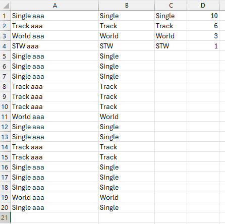

Posts: 3383
Screenshot below
A: has list of things to search
B: has this in B1, then dragged down to B20 to auto update the references =LEFT(A1, FIND(" ", A1)-1)
C1: has this which automatically pulls out the unique entries from B1:B20 =UNIQUE(B1:B20)
D: has this in D1, then dragged down to D4 to auto update the references =COUNTIF(B1:B20,C1)
