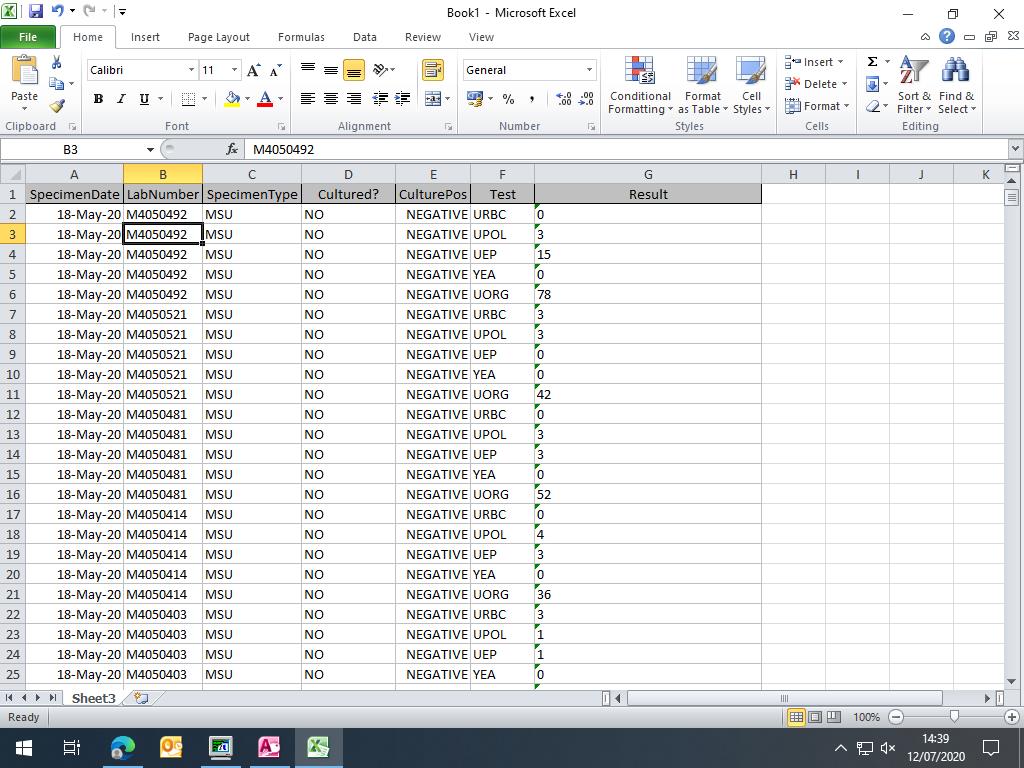

Trying to compile some data at work but i've reached a point where it's beyond my skills!
[img] [/img][/url]" alt="excel" />

Ok
Column B show sample number
Column F shows tests carried out on the sample, column G shows the corresponding result for each test.
There's usually 5 tests (sometimes more) for each sample, so for each sample there's 5 rows.
I need the tests in F to form new columns with headers and the results in G to show in the correct column all on one line for each sample number in B.
Does that make sense!?

excel
oo, that worked a bit better!
So you can see the tests in column F need to form new column headers
URBC UPOL UEP YEA ORG
Then the corresponding result from column G dropped into the right place along one line for each sample number of column B
Posted : 12/07/2020 3:19 pm

It sounds like all you need is In H1 to L1 put each of the test types URBC etc.
Then in H2:
=if($f2=h$1,G2,)
Then drag fill across the columns and down the rows.

The easy way of doing this is adding the columns to the list for each test type and then using some if statements to populate the value if it is that type of test (example below).
The more elegant way is to use a formula in a seperate sheet (which can be a template of sorts) to display a filtered list, and then look up and populate the values for each test type if they are there, but I don't quite have time to work through that solution right now.

twisty's first solution works if there's a fixed number of rows for each lab number. The difficulty is that the number of rows isn't always 5, so the position of each test result isn't fixed relative to the first row. You can't simply use VLOOKUP to find the result for each test as you'll have to set the lookup range to allow for the maximum number of rows for any lab number, so in some cases you'll catch the results for the next lab number. I would try adding a temporary column containing a concatenation of lab number and test. Then you can use twisty's approach and reference column B concatenated with the column heading and do VLOOKUP on that unique value.

Unless i have the wrong end of the stick thats got pivot table written all over it.

Oh, I just read the bit about wanting all identical sample numbers on one row. You can probably do what I suggested and then add a pivot table. Vlookups are good if the data is guaranteed to be structured a particular way... of course this is yet another example of someone using excel for something which it really isn’t great for - and it would be better investing a day in learning a basic level of software/data analysis like python to do it properly (where at least erroneous data will be labelled as such).

Thanks for the help so far, I tried the formula suggested above, I can see how that should work but it only works on the one cell I apply it to, it doesn't drag and populate the rest of the table.

If you have a list of number going down and you just need them to go across then you can do paste special transpose, don't know if this might help you.

You could use an array formula to reduce tje test numbers to one row for each.
Then you can use a concatenation formula of test number & test results from the entries against new rows and column headings.

OK I have no idea how skilled you are in Excel. I’m going to assume not. So when you say doesn’t drag and populate to the rest of the table - do you mean you don’t know how to fill down and fill across? If that’s the case I am guessing you don’t know the significance of the $ signs in the formula? I’m not sure I’m comfortable providing Excel help for a medical related solution where the risk of error could be high and the user is unlikely to spot it easily. However, if you want to copy a formula down you can select a cell and then drag the bottom right of that cell down or across. It’s Vaguely intelligent so tries to assume That you want the cells it points to to change as well but sometimes you don’t - and so the $ sign comes in handy. If this is news to you search YouTube For FillDown Excel and you should find something. If I’ve just patronised the hell out of you, apologies, but tell us more about what you couldn’t do.
Now you probably want to find a tutorial on Pivot Tables. BUT be warned they are not fun, and if you appear to be competent at them everyone in your department will come to you for all excel needs forever.

Pivot tables are fun ignore poly.
But as Poly alludes to... Tell no one.
My approach fleshed out a little would be.
New column in source data concatenate labnumber&test&anythingelsethatosrequired.
New sheet.
Starting at a2 place index formula for lab number (this is an array formula you need to read how to enter these for them to work)
This will generate a list of all the lab numbers but only one of each.
In b1 moving horizontally index formula for test to create one instance of each test as column headings.
Thats your table laid out.
For the actual data in the table its a lookup (i can never remember which one h maybe) that tests rowheader&columnheader using appropriate dollar signs that returns the result.
That definitely works, i have used it before.
Its nice because its totally irrelevant if the data changes more tests get added different lab numbers get edded whatever.
Posted : 13/07/2020 6:26 am

I already compiled the Excel data by grabbing it a different way from access, but that jumbled some of the test result orders up, I can check if this occurs.

I understand the fill down function and I can fiddle with pivot tables. You're right about those, useful but the first time people see it they think it's black magic!

I've just mocked this up in Excel and a simple pivot table does exactly what you want doesn't it?
Lab number in the rows.
Test in columns
Result in values
That will give one row per specimen, with the test code making up 5 column headers.

Pivot table is the cleanest/quickest answer.
Severla alterantives using either SUMIFS or INDEX/MATCH
if you can copy paste the labsample number somewhere then use the DATA_Removeduplicates button you've got a list of unquie tests making up your new rows for Sheet2.
Repeat for Test and you've got the column headers. Copy_Paste Special_ transpose moves them to be laid out columns
then use a =sumifs(G:G,A:A,NewRow1,F:F,NewCol1) and fill the table to lookup /sum all results that have the labsample number in your row, and match the Test type in column header
