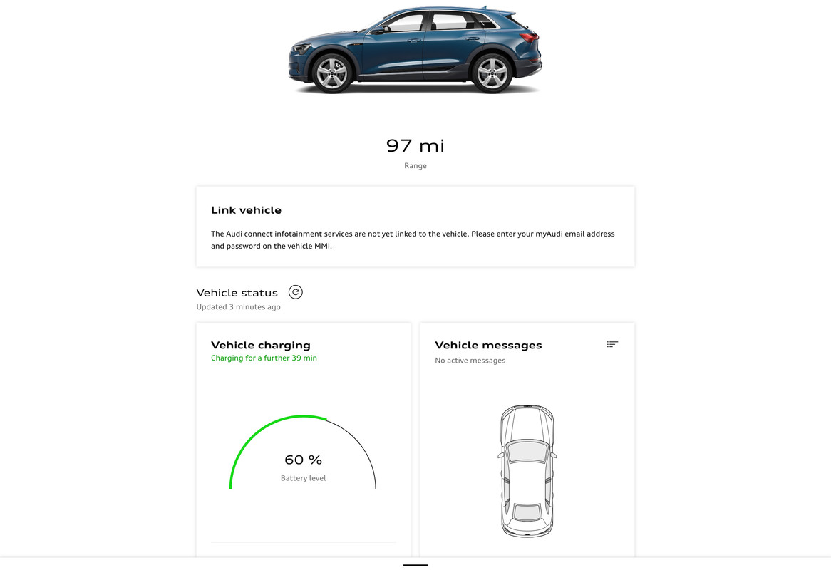

A lot (over 10) people in the work gqt Audi etrons on a super cheap lease deal and everyone to a man is happy it is a lease and that they didn't drop £60,000+ owing to the particularly poor range of around 130 miles in winter (a few have been to Audi and are getting software updates that do nothing). I stuck with getting a nearly new Octavia and glad I did (hybrid does seem to make more sense)
I have the E-Tron 50 and that was my range when it was between -4 and 3c now the weather is warming I’m seeing over 170 miles. An hour to charge? Only from almost flat to 80% on a 50Kw charger. 150Kw you’ll be on your way in 20 minutes.

Having said that (and relevant to the OP) Audi say the e-tron has a 95kwh battery of which 86kwh is useable (that ~80%), Skoda say theirs has a 82kwh battery. In which case, how does it pull off the trick of longer range if, presumably, it's going to be an e-tron in a primark t-shirt? Or are they using a different basis?
