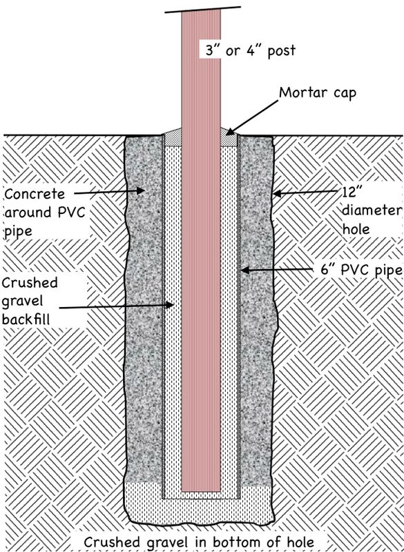

Get some soil pipe lengths bigger than your posts. Say, 8 inch diameter. Hammer lengths just taller than ground level height in the post locations and use them as void formers.you really dont want to be digging back out compacted stone or rubble just to make post holes. Fill with MOT and compact in layers 200mm deep max.
Depending what you want there afterwards, you might want 300mm topsoil to bring up to ground level, or you might have aub soil you can re-use.
When complete, put posts in pipes and tip in postcrete. Done.

Posts: 13369
Sort of like this but with the back fill inside the PVC going higher up so you don't have so much post in the hole
This is kind of close to what I was thinking, but with Gabions and rubble.
The posts are 2" dia. so I was thinking circa 1m3 gabions. Stick in the hole down to a bit below ground level, set a soil pipe or similar into the location required, then fill the gabions with rubble/soil/rock. Tamp down by hand with a mashy stick. Put soil back into holes not occupied by big wirey baskets.
Then simply fit posts into holes and fill with postcrete.
Sound daft? Bearing in mind my limited skill. Getting the pipes to stay in place whilst whilst I backfill with rubble is my main concern. Spec for the post is that only 600mm is buried, so can't afford to leave 300mm soil exposed unfortuantely.
