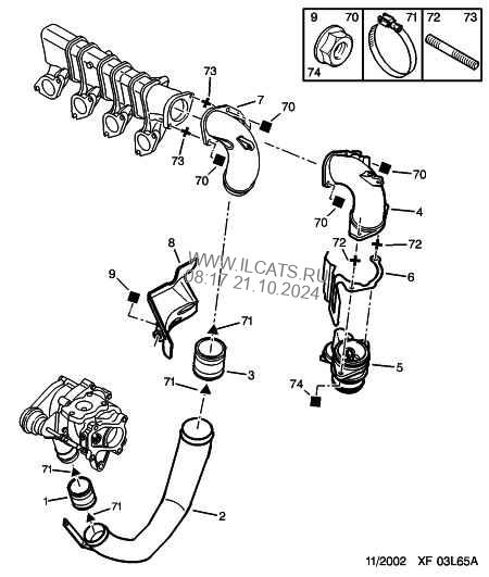

I've got the same engine in a Berlingo.
Have a look at the flexible turbo pipe - take the drivers side wheel off and have a nosey in - you'll see it behind the engine-nice and easy to get to. It's held on with two jubilee clips. Mine needed tightening.

I don't think it's a turbo pipe, but you can often hear hissing as you drive along or accelerate. This test is best done whilst driving along sedately on a side street to a wall with the windows down. Then start accelerating - the hissing is clearly audible reflecting off the wall.

The torque app will tell me boost pressure,and fuel rail pressure, but I havent checked those yet, and doesnt the turbo only kick in about 2000+rpm, and undr load? Can probably get some readings there.
correct. Its also worth noting a split pipe will still give you some pressure, just not as much as normal.

Take the drivers wheel off, behind the strut is access to the flexible. It's the first port of call.
Dropping the strut off to gain easier access to the turbo isn't difficult either.

RNP I can try that tomorrow, but got a broken screw in my collarbone so a bit restricted physically.

is the flexi pipe part #1? turbopipe
Its covered in oil and cant see the back but clips etc all seem to be in order

Posts: 1350
I had another look while waiting for the garage to call me back, and noticed the air inlet pipe loose on the manifold, pushed it back on, and everything seems to work properly now!
Thanks very much for all your help,especially RNP
Looks like I'll get another year out of this old car
