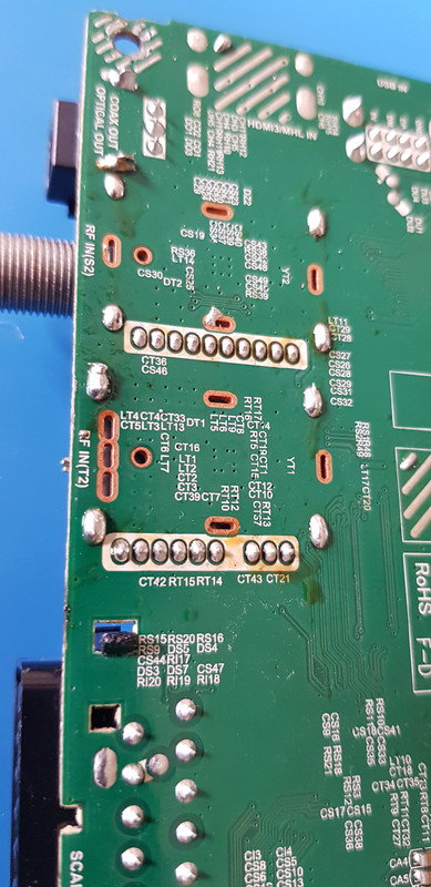

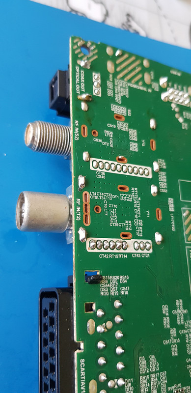

Yeah, I did.  Continuity between everything that's connected to the outer shield.  Various resistances measured between the 9 smaller pins (I.e. no shorts). Well, I measured between adjacent pins at least.
I thought my soldering looked ok.
The board as it came out, with knackered tuner:
Before
And the new one fitted:
After

Posts: 1844
Has the pcb got tracks on the top side, if so the holes might be through plated and the can be easily damaged when the old component is removed?
Posted : 21/05/2023 7:10 am
Posts: 272
@Bruce, it could be that,  though I'm reasonably confident I didn't damage anything during removal of the old component.

Posts: 6513
As per Bruce above - it's a through hole tinned/plated hole. Solder sucker the joints clear and flux/rosin the shit out of it. Possibly put a small spacer under the tuner so the tuner body doesn't wick the heat out of the join before the solder flows through.
