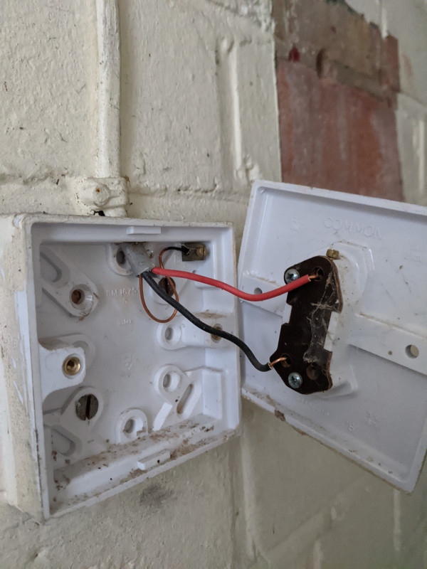

This is what we have at the switch.

Yeah you need one more wire in there.
And to shorten the exposed copper... and to put an earthing sleeve on....
You can probably tape a three core and earth to the other end of that wire and pull it through.
Posted : 04/11/2020 8:31 am
Posts: 3991
Yeah to avoid confusion that black cable isn't a neutral, it's either the live or switched live.
Posted : 04/11/2020 9:06 am

IANAE
Okay so the way your switch currently works it sits between the live wire and the lights which are all connected to the neutral wire of the lighting circuit.
You turn it on makes the live circuit to the lights complete thats why the black isn't neutral at your light switch that black wire should have a bit of brown tape on it BTW to signify switch live. Depending on how it was wired (by the look of the switch... Badly) that might involve connection boxes to achieve it or a string of connections within the lights.
Because there is no neutral the is no power permanently supplied to your switch. A PIR needs power either from the circuit or a battery.
The nearest connection to the lighting circuit is at the light or connection box at the other end of that light switch. If you trace it and wire the PIR there you will have everything you need with out running a new cable all the way to the lightswitch which isn't a perfect place for the PIR anyway.
You would be better with a sparky to be honest especially as this is a commercial property...
Posted : 04/11/2020 11:25 am

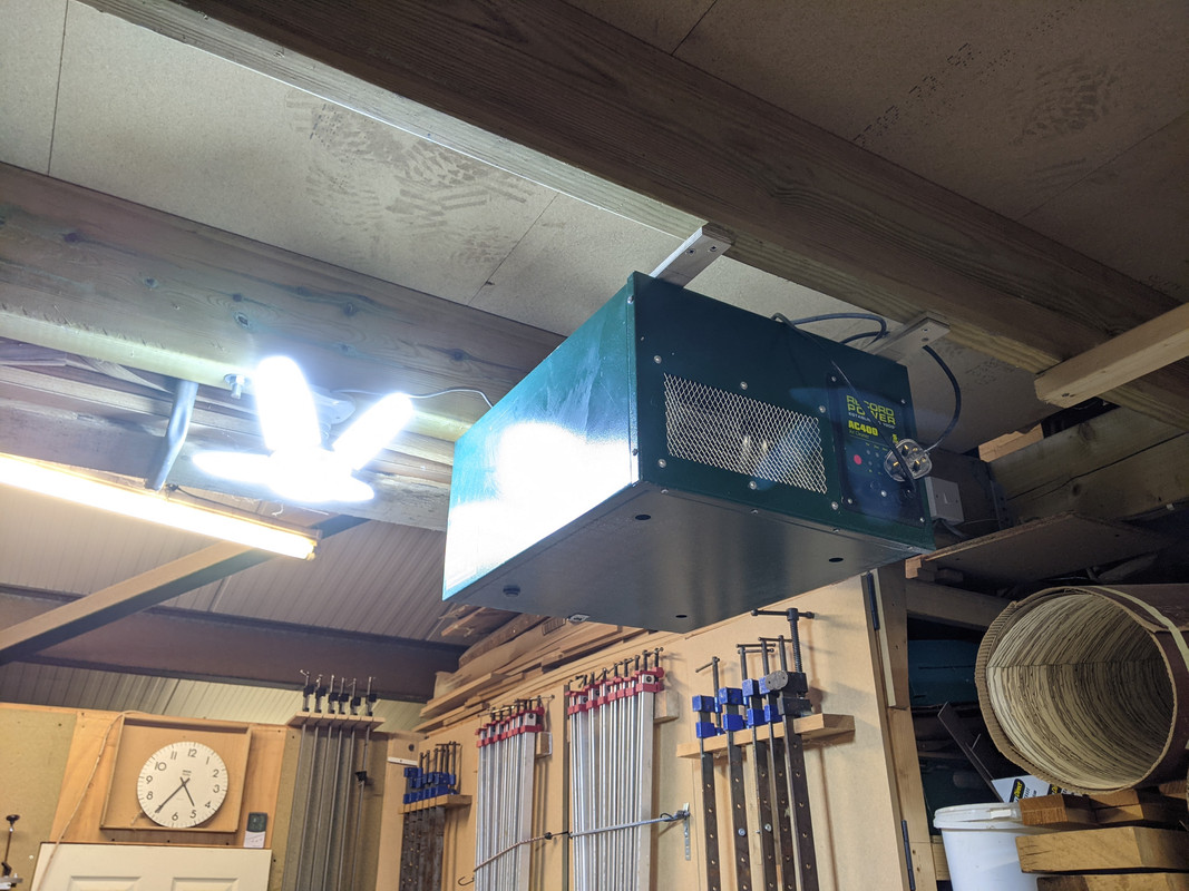

Thread resurrect for another question for you wonderful electrical experts.
I have just got myself an air dust filter for the woodworking workshop and stuck it up on the ceiling.
I don't have a plug there of course.
Could I simply remove/split off that light socket next to it and wire the air filter onto it instead (if it has an earth) so that it comes on with the lights?
Apologies if this is certain death.

Posts: 4985
My guess is no, but IANAE
Posted : 11/02/2021 8:32 pm
Posts: 877
Certain death I'm afraid.
Light circuit 5A
Your dust filter 13A.
You need to get a socket up there from your 13A power circuit.
Posted : 11/02/2021 8:48 pm

Should be a problem for someone talented enough to walk on the ceiling.
Posted : 12/02/2021 7:55 am
Posts: 918
You actually could as a bit of Googling reveals that it is only a 100W load; this equates to 0.43A at 230V. Such a small motor shouldn't have any significant start-up current either. It does depend on how much load (number & wattage of lights) you have on the existing circuit to ensure it doesn't exceed the fuse/cb rating, but in a small workshop I can't imagine that'd be an issue.
The socket, assuming that's how you connect it, should be labelled up that it's only for the use of the extract unit and not for general consumption. You'll also need to ensure you connect it to the switched live and neutral in the light, depending on how it's wired you might also have a permanent live there (if it's a loop in system), although again that's unlikely.
It might be worth connecting it via an unswitched fused connection unit, or even a double pole switch as a point of isolation, although the plugtop would suffice.
Posted : 12/02/2021 9:58 am
Thanks creaking door.
I just wanged a new 5m cable in the machine and plugged it in on the wall 😊👍
That pesky Lionel Ritchie has been in here again 😡
Posted : 12/02/2021 10:02 am
