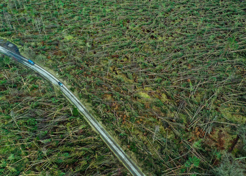

Posts: 2295
No power lines involved here but gives an idea of the level of tree damage caused by the storm.
Posted : 02/02/2022 9:47 am
Posts: 4313
@beamers, that's incredible. If that level of damage becomes common I can't see how the timber industry let alone overhead power can survive.
Posted : 02/02/2022 9:51 am

The guy from Forestry England at one of the public meetings was saying around a million trees lost. My mind cannot comprehend that sort of number in fallen trees.
10 years of recovery work for reestablishing the forests he reckoned. Some of the tracks in Keilder shut until summer just for clearance of the fallen / damaged trees.
