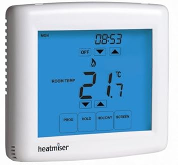

One of these and add a relay for 13A switching....
