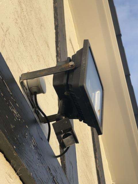

This is the thing in question:
( How does the round junction thing work - just unscrew the top? )
IMG_0643
Posted : 23/10/2023 9:28 am
How does the round junction thing work – just unscrew the top?
Just pops off, flatblade screwdriver would help.
That looks like an old halogen lamp thing, you should change it for a LED one, will save a fortune, 20W vs 250Watts!

ooo that might make things even easier - I would expect the PIR light to be connected to the circuit wire inside that box.  So it would be a matter of disconnecting the light wires (its probably on a live and neutral) and terminating the wire from the house (with those wago connectors or terminal crimps)   You would probably be fine leaving it as is until you have a new light fitted.  maybe a blob of sealent on the hole unlikely water will get in from underneath though.
as for removing the top of the box, not seen one of those before, but the square ones are normally just clipped closed, can be quite stiff and you may need a screwdriver to open it.  Or some have a couple of screws.  Should be obvious when you get close
looks like it was well fitted btw which should give you some confidence in changing it.
You might find the terminal box is full of water.  When my lights failed its because of water ingress.

Assuming you don’t want to replace it the best bet is to trace the cable in the loft back to where it is taking its live feed from.
Aha - I had assumed it was going back to the consumer unit but your comment makes more sense! Unfortunately the loft is an absolute dog's breakfast with boarding and insulation done at different times.
Climbing up a ladder as far as I dare, I see some adjustment dials on the bottom of the sensor. After some Googling these seem to be sensitivity, light, and time, so I turned them all to minimum to see if that helps!
Frustratingly, I'm sure this would be DIYable at ground level, but breaking a leg (or worse) for the sake of a 20 quid light feels wrong!!
So - supposing I wanted to fit a switch between the light and the ?ceiling rose? it's connected to, what switch should I get (the cable is just lying on the boards in the loft)?

In a different life I used to have to fit outside lights, the pir probably has spiders or water in it.
In all honesty I’d probably just disconnect it and sling a few LED Solar powered units up at a serviceable height.

+1 on spider web.  After ages blaming foxes or cats realised it was combined wind and rain made wet spider web swing in front of sensor.
Replaced quite a few old halogen floods at my mums house over the last 5+ years - DONT buy the cheapest of the cheap LED replacements because as you'd expect they're crap and fail quickly.   The Luceco ones I got seemed better than the others
https://www.screwfix.com/p/luceco-castra-outdoor-led-floodlight-with-pir-sensor-black-30w-3150lm/826kj
