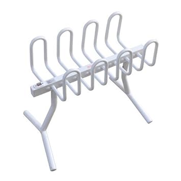

Hmmm. Nice bit of tinkering, but I can't help but think this would probably have got my vote....
http://www.clasohlson.com/uk/Shoe-Dryer/18-4300
Posted : 17/03/2016 1:02 pm

Ive just got one of [url= http://www.clasohlson.com/uk/Pr184300000/Pr184300000 ]these[/url] in the garage. Works ok for damp but still needs a bit of radiator or kept in the house to dry soaked-through shoes. only £20 though.
shoes not models own 😆

I have the Clas Ohlsen its spot on and quiet.
The plumbing version looks well made but over complicated, be careful it doesn't deform your shoes

Of course I opted to buy a set of heated, fan equipped, UV emitting bacteria killing ones for £9 delivered but each to their own.

We got one of these in Coopers sale for £12.99. Dries four pairs of Five Tens overnight.

I bought the Clas Ohlson one too. Works really well, I have it plugged in in the garage, get home stick it on and shoes are dry for the morning. Quick blast heats them up for leaving on a cold day too.
Good effort though
