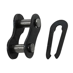

Could you not use one of the old style removable links like this:
It would be relatively easy to slide the retaining 'plate' off one-handed, instead of trying to remove a connector like this:
which requires the chain to be flexed sideways, and over time wear would probably make it even easier, and would only require the open ends to be closed up a bit with pliers if it gets too slack.
A lobster-claw type bracelet fastener would have to be huge to fit a bike chain.

Ive got an old one like the first pic count zero linked to. Very easy to remove
Posted : 31/07/2015 7:24 pm
That's what I was thinking, used to have them on the chain on my first full-sized bike, a BSA with SA three-speed; could pretty much push the clip off with a thumbnail. Should do the job nicely, get a stainless chain, and a chrome-plated link, jobs a good 'un. 😀
