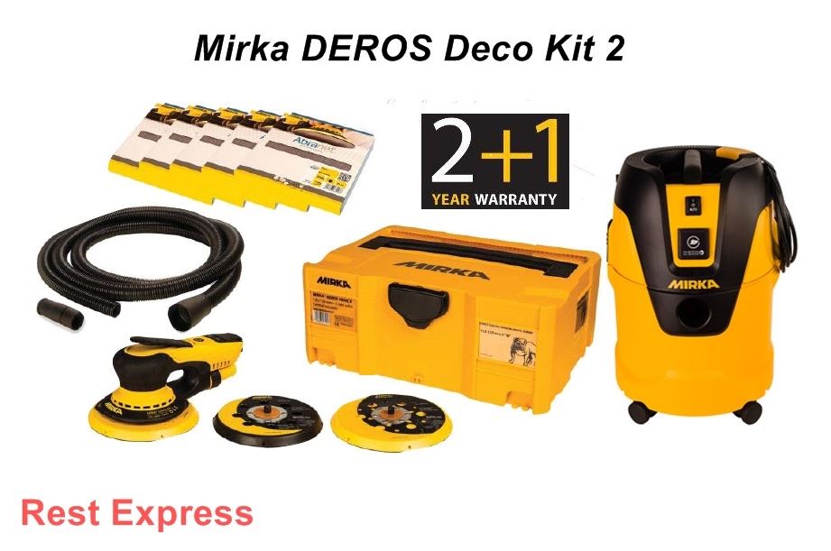

Related question, I have loads of wood to sand back, some with lead
Would it be worth paying up for one of those Festool systems ? I currently have a James which is ok, but I want as little dust as possible (young kids)
Secondly what sander would work best with this set up? My current makita orbitals dust extraction isn’t great
Posted : 10/02/2019 7:33 am
I really rate the Mirka Deros sander if you're going to spend a bit more. Most Sanders are quite top-heavy but the Deros with it's brushless motor keeps a very low centre of gravity..very nice to use.
It's very lightweight in the hand and uses a paddle switch. It's favoured by decorators doing walls etc.
Team it up with Mirka Abranet sanding discs and the dust is very minimal.
In fact, put Abranet discs on any sander and the dust extraction is better. Your current sander will improve with Abranet.
Only thing with Abranet is they're a little more fragile so you have to watch for catching edges when doing narrow stuff, and they're not so great for aggressive sanding.
Posted : 10/02/2019 7:45 am

Chemical strip would be a ball ache.
It’s a hall wall with 5 doors, 4 original windows, stairs, cupboards and all the trim. It has a top layer of non lead paint so a bodge would be to key it and over paint but I’d really like to get it looking much smoother an£ nice if I’m making the effort
Looks like £1k for that kit.....ouch....still a third of the quotes
Posted : 10/02/2019 8:54 am

Looks like £1k for that kit…..ouch….still a third of the quotes
You don't gotta get the vacuum and everything. Not even the sander really. Just using Abranet discs improve the extraction a lot over regular 6-hole discs.
Just try some Abranet on your own sander and vac and get a decent respirator.
They also do a hand-sanding block that you can then attach to your vac and use Abranet rectangle sheets.
Posted : 10/02/2019 1:56 pm
