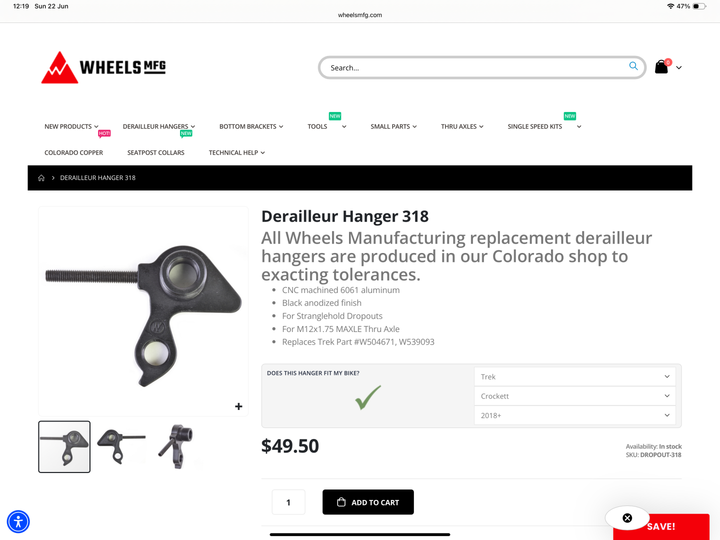

Posts: 2701
IMG_0204.png This is probably the hanger that you need and it indicates a thread pitch of 1.75. These, and corresponding axles are available from Freewheel or any bike shop (most) with an account for Madison, the importer. Hope this helps

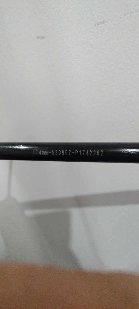

Posts: 4671
This is the writing on the axle.

Posts: 2701

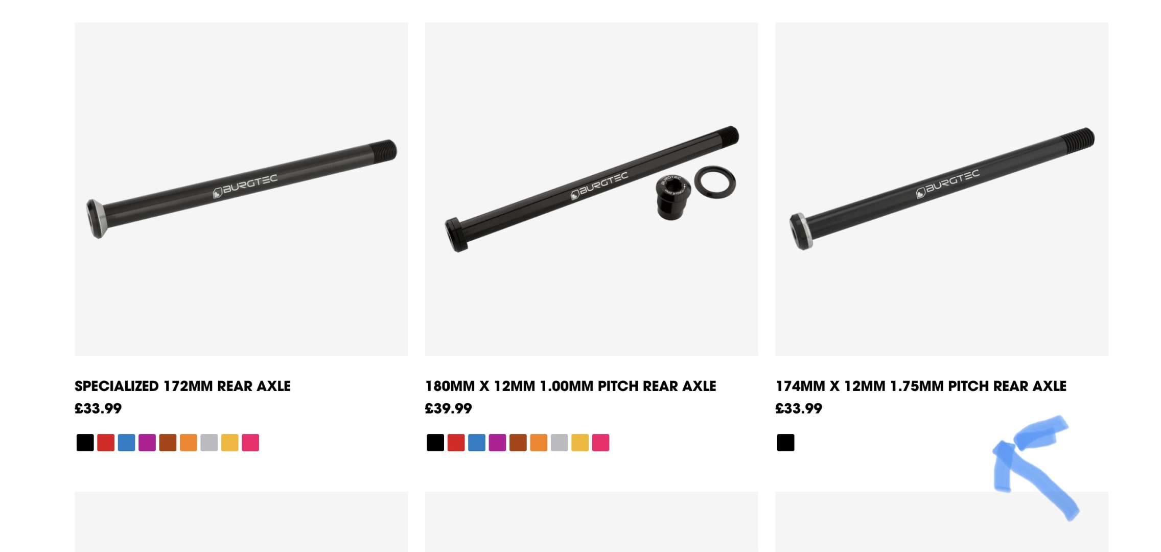

Is that a picture of the dropout that I posted above? If it is then it’s a 1.75 pitch, measure the complete axle length from below the cap and then measure the length of the threaded bit. These three measurements (plus the 12mm diameter) should give you enough info for a replacement from BETD, Wheels Manufacturing and others. The numbers are probably the Trek part number but I’ll check on DT Swiss for you.

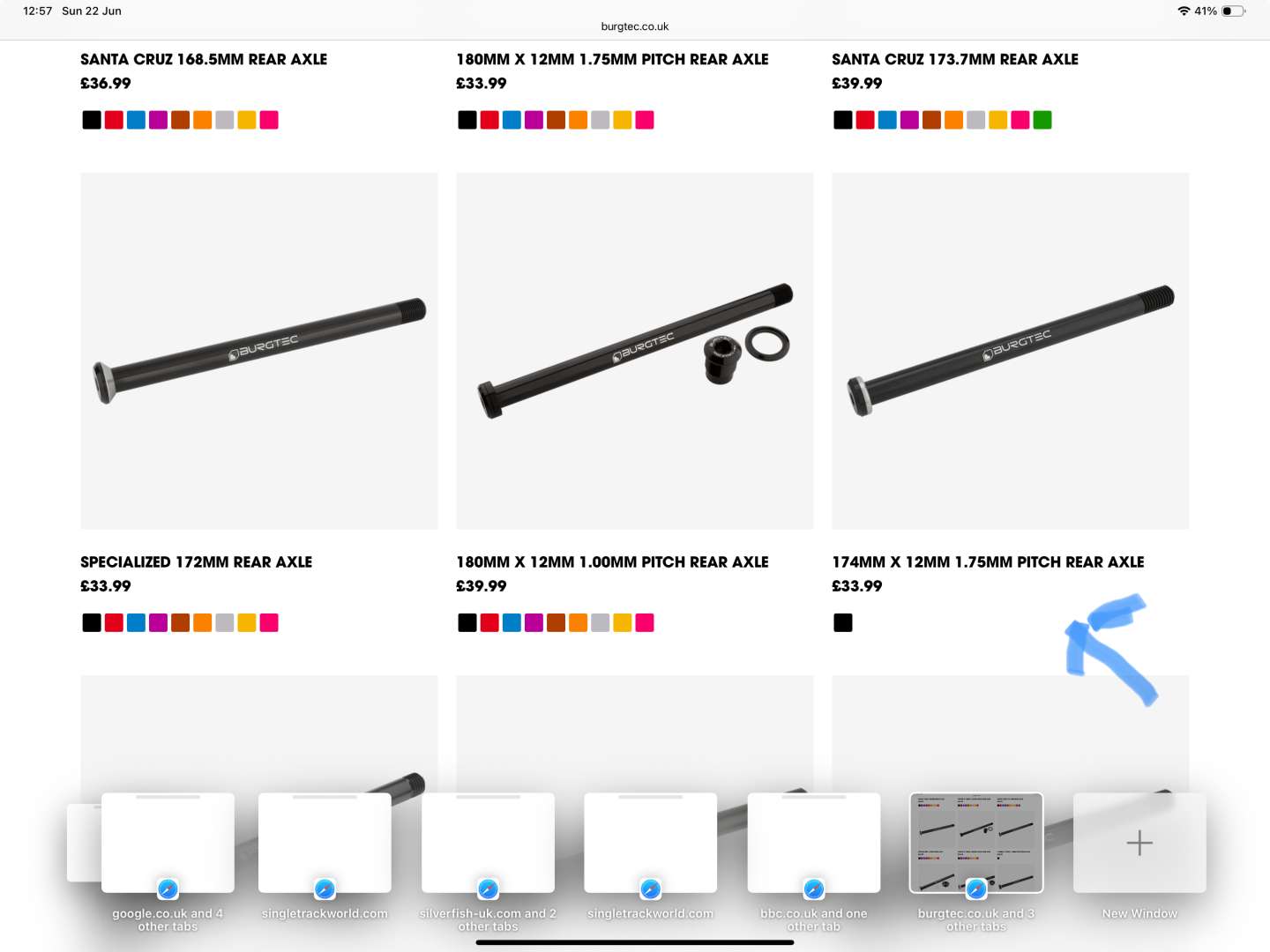

1.75 pitch makes sense as the Giant one I bought apparently has 1.5 and doesn't fit.
I'll check out the Burgtec one but ideally would prefer another DT Swiss one that doesn't require an Allen key.

Posts: 2701
Sorry, don’t know what’s happening with the double posts! Anyway, if you’re still unsure then give Burgtec a ring in the morning. A very pleasant company..
