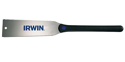

I'd be reaching for my double sided pull-saw with the rip-teeth on one edge.
I've got a dead posh one from Workshop Heaven which is amazing, but I've also got one of these Irwin ones from Screwfix which is actually pretty good.
You can clamp a block to the work as a guide but usually if you get set up nice and comfortable you can make good cuts without.
