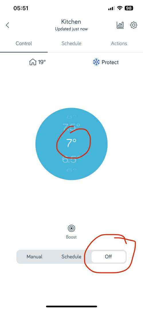

Posts: 3296
@cougar - so if you go to this screen and select off it goes to 20?
Posted : 18/03/2025 5:55 am
Posts: 5012
No he’s saying when you turn it on it goes to 20. He wants it to go to 18 without fiddling each time.

Posts: 3562
This seems to be describing the same problem you are having - which does sound like a bug / feature.
Your best bet is probably to create a dummy schedule (e.g. 7c all day, every day) and then use the boost feature to bump the temperature as required. If you Boost it in the app you can adjust the max boost temperature which it then remembers for next time (including for Alexa).
Posted : 18/03/2025 7:38 am
It's exactly this, yes.

The app is installed but I've barely looked at it.  I think I wiped off what seemed like ten thousand preinstalled schedules and set up one to rule them all, but I'll need to return to it to check exactly once my phone is charged.  This shouldn't matter as it's in manual mode, I'm not using schedules (though of course, "shouldn't" doesn't mean that it won't...)
When I say "off," it isn't actually off off because gods forbid that any 21st Century appliance would do that, rather it goes into an anti-freeze mode which is 7' and shows a big snowflake on the display instead of a target temperature.
Control is via Alexa.  There are no routines, I'll worry about that when I have basic functionality.  You can also control it manually via the thermostat but neither I nor my partner want my partner to be buggering about with that.  It's taken me the best part of three years to get her to understand the "auto" setting on the climate control in the car rather than me being blasted backwards out of my seat by the Fires of Mordor after she's been driving it.  This is what boils my piss, I specifically told both the guy servicing the old boiler and the subsequent other guy and young lass installing the new one that I didn't want anything complicated because whilst I love my partner dearly she is a luddite.  The first I knew about them installing a Hive system was when the installer's Padawan asked me where my router was.

I can't even find scheduling in the app now.  Hateful bloody thing.
Posted by: pocpoc
Set a routine in Alexa. When you say "alexa turn the heating on" get it to follow a routine with the instruction "alexa turn heating to 18 degrees".
Oh, that's genius, if it works!  Why didn't I think of that?  Fool of a Took.
Posted : 18/03/2025 4:53 pm
It works!
