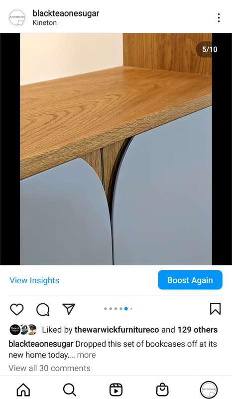

I paint built in furniture with my cheapie Rutlands HVLP gun.
It's £50.
Takes a bit of practise to get the hang of the finish you want but building up the layers with a denib gets pretty good results.
I only use water-based paints.
You get a little viscosity cup with it and I seem to have settled to around a 30 second viscosity flow which mostly works well.
For a wall as you describe, I doubt you'll be so bothered and it should work very well.
You do get over-spray/mist, so mask well and cover and wear a respirator.
I did these cabinet doors with it and it turned out pretty well.
Posted : 19/07/2022 10:46 pm
