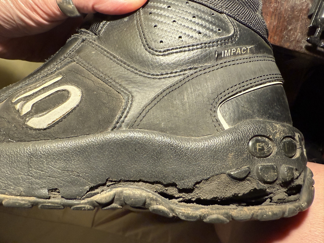

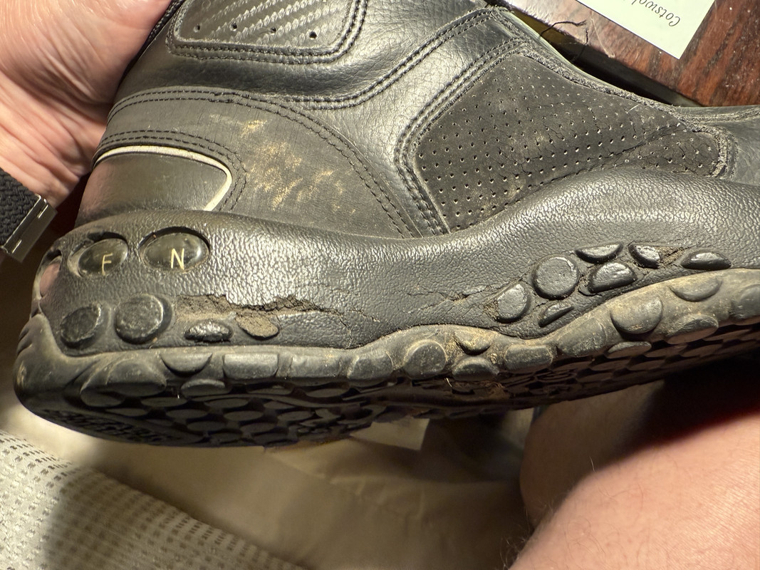

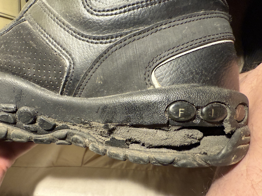

As clearly shown in the photos! I might get a tube of that, I’ve got some shoes where the rand has started to pull away, but are otherwise not too bad condition-wise.
However, it wouldn’t work for a pair of 5:10 Biking boots where the midsole has literally disintegrated, while the actual rubber sole and upper are hardly worn!
Nigel Rodgers at resoles.co.uk had a look at a photo and said it’s not possible to repair them, sadly, the issue is something called Hydrolysis and there’s no complete sole units available. I have thought of getting some two-pack expanding foam for flotation devices, mixing some up and pouring into the space and taping around the edges until it sets. Frankly, nothing much to lose, really.

Yeah I had some meindl boots do that on a walk once - left the car all ok, came back 3 hours later with the soles flapping off. I looked at them and thought there was no way I could repair them, there was nothing left to glue. Luckily meindl had the midsole and sole, so they were put back together
If the void/cavity isnt too big you might be able to mask them up and pour in some aquasure. But it'll take a lot of it, and it's not cheap and not guaranteed. Shame, as you say the tread looks fine

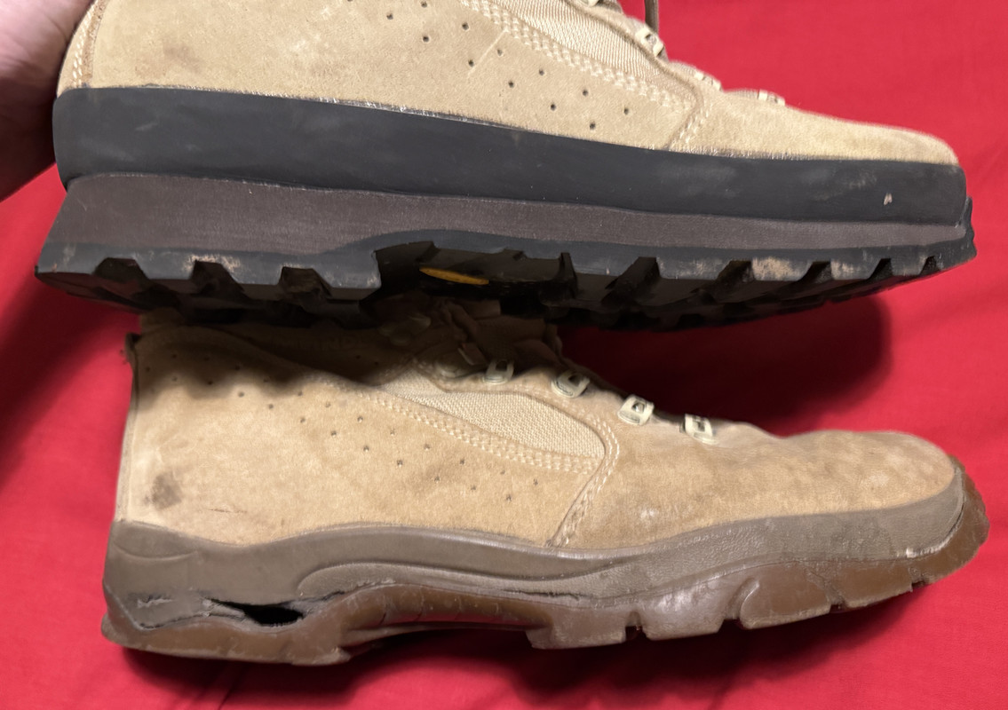

Funny you should say that, I bought several pairs of Meindle Desert Fox army boots from eBay over a period of time around ten-twelve years ago, I wore two pairs pretty much constantly, to work, out walking, to the pub, wore the soles out and had them resoled, then when I changed jobs I could only wear them at weekends, or whenever I was off-shift, then when I stopped working, I dug them out and started wearing them again. I noticed something a bit odd about how they felt, a close look showed both of the oldest ones had the midsole collapse, so I checked the third pair I hadn’t worn so much, the same had happened, then I checked a pair that were basically brand new and I’d stored them for when I’d killed the oldest ones, and the same thing happened!
I was a bit miffed, but I’d never paid more than £40 off eBay for any, so I sent the newest pair to Nigel, and he’s put a complete new sole unit on them for about £90, which I consider worth it, new retail they were £170, so I’m still looking at a brand new pair of boots, £40 less than they would have cost, and with a sole that won’t spontaneously turn to powder, and can be properly resoled in time.
The remaining pair, which have the uppers a bit dusty and scuffed, I’m sending to Nigel in a month or two, then I’ll have two pairs that I can rotate and spread the wear out.
They’re such comfy boots, as long as the insides and outers are in good nick, and considering how little they cost me, I can justify the cost.
The uppers are identical but the rand and sole are totally different, despite the appearance, both boots are roughly the same sort of age, it’s just that the top pair have spent the last decade or so stashed away in a wardrobe…
