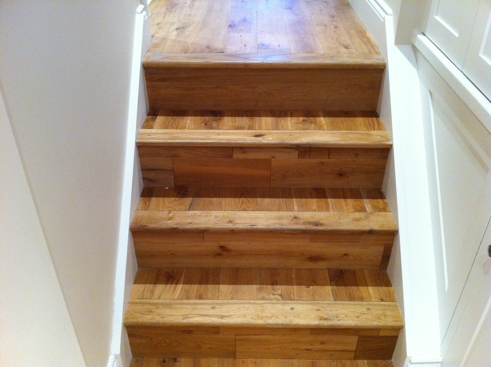

something like that - although obviously that was made as a one piece....
[url= http://hardwoodfloorsmag.com/articles/article.aspx?articleid=524&zoneid=2 ]Stolen from the "hardwood(floor) mag" .......[/url]

it seems the best bet is to make and glue/brad on a small 1/4 inch deep x 1 inch or so to the nose of the flooring and then router with a 1/2 round bit on both sides.
Routing is quite easy really but for something that thin I would make a small jig that the 1/4x1 board can sit on flat and that is 1/4 high to make the router sit flat while you are doing the routing. Then glue it on to the nose
BUT
if you glue it on to the edge is it not likely to come off after it is stood on a few times?
edit (after your pic): Yep, that's what I imagined that you were doing. I'm sure it is technically possibly to glue a piece on to the edge that will stick but I've never managed it on something taking that weight :(.
edit2 (after 2nd pic): Now that is much more possible 🙂 . Route the top edge and then add a small piece underneath with the same profile. As above though, make a small jig to sit the strip in for routing and do a whole length at once and then cut as slackalice suggested. You could even glue the piece first and then route afterwards but i would then recommend lying another piece of the same thickness onto the board while you are routing just to keep the base of the router flat as 1in wide isn't much to sit the router on

Hokay, so, dependent on a number of items, chiefly what kit you can have on site, a table saw being what will save you most time on this job.
Personally, I wouldn't go for the look in your picture above, where the treads are cut from loads of short pieces with a nosing running at right angles. It looks very busy, your joins would have to be cock-on (lots of them) and (again, personally) I feel that this is a weak joint for a staircase. Also, all your short cuts would have to line up as you look up and down the stairs, which will be a bit of a ball-ache. Also, bevelled joins on risers don't look great (but one across the whole width is acceptable), nor do risers made from two or three different pieces of t/g flooring.
I'm assuming you'll be making the nosings out of the solid wood flooring you've got?
So, should you heed my advice and go for parallel joins for the treads and risers...and start from the bottom up!
I'm going to give you the sequence for making one riser. You can break this up into doing each stage 12 or 13 times (depending on how many treads/risers you have) but you should do the first riser and tread in one whole go. Hopefully all your risers will be roughly the same height. You'll be making them all around 10mm too high (allowing for the thickness of your new flooring on the tread!!) or if two boards joined together is higher, then join two boards together without running them all through the table saw. Take the micro-bevel off the groove side of your riser...this will be the bottom half of the riser. Take the tongue (and micro-bevel of this board also. Take the tongue (and micro-bevel) of the second half of your riser, again using a table saw. Router a biscuit channel along the two sides that used to be "tongued"...20s preferably, but 10s would be acceptable. Glue (PVA is fine, but PU is better) and join. Use this video to make up parallel clamps from off cuts (they're flipping awesome) and clamp the riser together.
Once your riser is dry, offer it up to the step and cut it 2 or 3 mm ([i]x[/i]) higher than it needs to be.
Next the tread. Hopefully you can machine something like this, using a half-round cutter for the nosing and a straight cutter for the channel underneath. The total width of the nosing should be around 100mm/4" so that 3/4 of it is sat on the tread and the other 1/4ish os your over hang.
The channel depth should be [i]x[/i] + another mm or 2. Your over-hang should be around 20mm, so the front side of your channel should be nice and straight, but the back-side can be free hand if you have to do it in a few passes, as long as it's as wide or wider than the thickness of the riser.
Make up the back-part of the tread, removing the the micro-bevels as above and joining as above. Run it through the table saw to be 10 mm off the [i]existing[/i] riser, and thus the gap is covered with the next riser that pops on top.
Repeat until your hair falls out.
Nah seriously, it sounds a faff, and I realise some of the above is teaching you to suck eggs as I know you're a practical guy, but just trying to make sure I've put everything in.
Once you've got all your measurements from doing the first two, I'd just break it down into loads of stages and do each one multiplied by the number of pieces you need. That'll speed it up. Use of someone's workshop or router table would really help too if you have access.
Best of luck.

Cheers for that dd i see what your saying
Basically cut off all the microbevels and biscuit joint the remainder so it looks like wood and not wood flooring stuck to the stairs.
That will take more time but i can see the appeal. I will have a play when i get there- it might result in the redoing of my shelving unit drops :/ hum ho

Managed to find some time in between my other projects to make a dent in this today.
After seeing a set of three stairs done similar to how id like at my grandparenta i took a few pointers and added my own twist on it.
I couldnt face all the extra efford to do away with the micro bevels and kind of like the way it makes it clear the stairs are clad no real oak staira , its not pretending to be owt.
Added some spacer strips to the riser faces of my minging stairs.
Cut , glued and pinned all my risers
For the treads i used board the whole width of the tread for the front most board - put a 9.5mm half round on both sides using a jig i made from a pair of scaffoding battons and a bit of decking. Nailed it with hidden pins from the portanailer and sticks like shit under the whole tread.
Ignore the weights on it they are to ensure the joints close fully and the sticks like shit is fully adhered.
Stringers are staying white , saw a set done like this and much prefer it to wood covered stringers which was going to be a ballache to do and a bigger ballache to make look good. Bit of mqsking tape and plenty satin wood paint should sort them out, im pleased with the end result and most importantly so is mrs t-r which means i can get back to my landy rebuild which is a whole other thread as the progress on that in the last week has been 10 fold.
Cheers for all your help guys , even if it does look like i ignored some or alot of it , it was all taken on board and judgements made on the merits of all but im happy with what i got, im no carpenter , id probably have taken my fingers off trying to route new grooves and tongues 🙂

Posts: 39497
weights all off , nothings moved and everyone thats seen it has gone wow - its also not slippy in the slightest - but then i expected that having already used the same flooring else where.
thats close enough to good for me.
Im sure if i'd paid darcy to do it his way it would have looked nicer but i dont have the patience to pay the bills on that one.
Posted : 30/09/2014 10:45 am
Posts: 91088
I wish we'd have known this was possible before speccing carpet in our hosue. I could of course still do it but it'd end up different to the rooms, which would look crap.
Posted : 30/09/2014 11:34 am
That looks a damn sight better than I thought it was going too.
Good effort ,its got me looking at my stairs now.
Posted : 30/09/2014 5:18 pm
Posts: 11504
Good effort...should have painted the stringers first though 🙂 You'll put it off for another three months now!
Posted : 30/09/2014 5:26 pm
Posts: 39497
Spooky funny you should say that... I did.
Only in keeping the wood tight i damaged the paint.
Ill ask mrs tr to mask it all off and paint it. Shes better at painting than i am
Posted : 30/09/2014 5:38 pm
