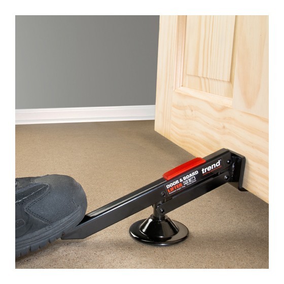

When you come to rehang the door you will find it easier if you can put something under the door to act as a lever to lift it into the correct position. I usually just use a screwdriver on top of a hammer handle but you can get proper tools like this:

One thing I did was knock up a couple of helpers to hold the door. Tke a couple of pieces of 2*4 timber, maybe 12 to 18" lond. Standing the pieces on the long, thin side, cut a square out of the middle so the bottom is continuous, but the door can drop in, then use wedges to hld the door in place - like this
Door holder

Lifting the door back in - I have a couple of wooden home made wedges to lift it to the correct height for the hinges.

The guys currently fitting my new front door frame are using these things:
https://www.screwfix.com/p/winbag-inflatable-air-wedge-160mm-x-160mm/1363K?tc=LA5&ds_kid=92700055262507126&ds_rl=1244066&gclid=Cj0KCQiArvX_BRCyARIsAKsnTxPrt4O1m5dh-8DLh7ofU1yg2otKF-15VHqTZMSRfrny3514ESFuSEsaAjeXEALw_wcB&gclsrc=aw.ds
Not suggesting you need them, a screwdriver over a hammer lever is enough in this case, but I wish I had known about these things sooner!
