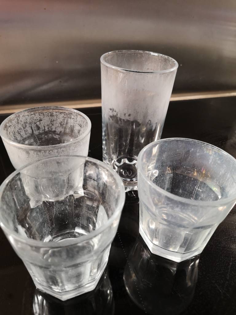

Dishwasher is great, except for cleaning glasses and how it leaves them. Pic shows old glasses that I never got around to finding out what to do about it.
Any ideas?
Hard water area. Finish tabs & lidls rince aid used. Have adjusted the rinse aid setting but I can't spot any difference, it's set to max at the moment.
  1. Cheers. IMG_20230928_191403
Posted : 28/09/2023 8:59 pm

Enough salt?

you could try this - worked for me - get citric acid crystals and dissolve a decent amount (third of a pack) in water in a cereal bowl. Put the mostly full bowl in the middle of bottom rack of the empty dishwasher (could leave your frosted glasses on the top shelf) and run it normally. Logic is as the water sprays down it makes the cereal bowl (acid water) overflow throughout the wash (as opposed to salt washing away immediately) and properly clears out the limescale. Took two goes for us - first round made a good difference and second made it run like new. Hope this helps

Can the arm spin freely when you stack it?

Do you fill the salt container regularly? Does it use salt?
I image there's a regeneration setting somewhere that let's you program in the hardness of the water to make sure the softener is regenerated correctly.
Tablets with salt in them are pointless. It needs salt in the container. Unless you're in a really soft water area of course... But you're not so definitely check the salt.

Im surprised nobody seems to be aware of the abrasive nature of dishwashers. Its been a thing forever.

Firstly, has anyone established whether the clouding is a film / deposit on the glass (indicating limescale and not rinsing off completely (what the salt AND the rinse aid  is there to cope with) or is it the surface being eroded (= nature of dish washers).

I'd suggest running some limescale treatment through the dishwasher on a regular basis. It looks like a film rather than actual damage to the glass. Do they come up clean if you hand wash and dry them?

they look like they have picked up scale over the years, if you give them a soak in some acid does it clear? Any acid as a test, descaler crystals, a bit of toilet bowl cleaner, some vinegar.... does it clear it?
In that case the issue is probably either salt content, but if you're using a decent quality tab and making sure the tab function is selected if you have one that should be controlled.
Or could be the rinse aid. It is possible to overdose rinse aid - the function is just enough to enable a thin film of rinse water to form that'll drain down consistently without 'lacing' or 'beading' and leaving marks - go too far and you can overdo that and leave a film that evaporates to deposits.
Dishwashers are harsh, with temperatures, chemicals and water pressures stronger than you can do in a sink (if you're managing in a sink then you have some MF serious asbestos hands or thermal mitts!) but they aren't so harsh they destroy glassware. Of course exceptions apply.....some glassware isn't DW safe so read the label. But for day to day IKEA type glassware I have no hesitation in loading it up. Mine don't go like that and if they did, I'd clean down with an acid rinse and go again.

When we moved to a hard water area we started getting this on glasses (even with salt in the maxhine)
We soon fitted a water softener to the incoming supply. Means having a shower is nicer, bathrooms are easier to clean, devices that use water will last much longer.
When it was fitted a load of sludge came out of taps, and it was incredible the amount of crusty limescale came off the end of taps
spray one of the glasses with viakal and if it comes of with a bit of elbow grease you know it’s limescale

What setting do you use? Ours used to go like that in our old Bosch if we used eco setting all the time, the occasional wash in the standard setting was enough to keep them good.

Also to add, it was our Duralex glasses that look exactly like yours that suffered, and them only (the front 3 at least, don't have one like the one in the back). Other glasses seemed completely unaffected. May be coincidence or something specific to them?

Crystal glasses would be ruined, the lead/magnesium/zinc content gets etched away by the strong alkali dishwasher water.
Other glass should be OK, but I've noticed my Pyrex measuring jug getting a little less clear.

Dishwasher solution is not abrasive its corrosive,  its so alkaline it actually dissolves  glass and its why you can't  wash Aluminium cookware in them.
OP check the salt and water softening settings. Dishwashers need salt to work properly, despite the tablet manufactures advertising them as "all-in-one".  Excessively soft water can lead to corrosion of glassware, but  under softened water leads to limescale build up on glassware.

Posts: 4726
Some good ones there peeps 😂
Lidls DW salt is used as well forgot to say.
Posh glasses, chefs knives & non stick pans get washed by hand.
Life's too short to hand   wash the loads of cheapo tumblers.
Will try and adjust wash settings as wash on eco 99% of the time and try the lowest setting of rinse aid as a start.
DW cleaner used every 3 months.

Top up dishwasher salt and use white vinegar as rinse aid. I use only Lidl dishwasher tablets and the cheapest white vinegar I can find and even in eco mode everything comes sparkly clean.

Tried soaking mine in vinegar, doesn't look like it's gonna work despite it being great on my granite worktop. But useful thread, my dishwasher was set to "average" hardness (we're in a hard water area)
