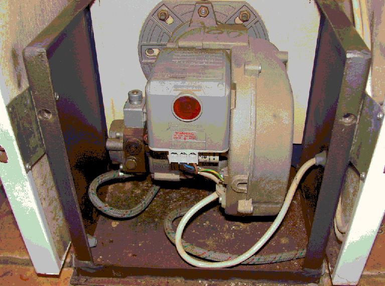

Posts: 13916
Certainly sounds like the optical sensor.
I'd it a riello burner (it will say on the box covering it)?
Pretty easy to work on and plenty on YouTube.

Posts: 13916
Oil fired boilers last about 10 years.
This is really not true at all. We have a boiler that is also in the region of 40 years old and is pretty rock solid as they're so incredibly simple (unlike 'modern' boilers).
Will hang on for the oil delivery
If you've got oil in the tank already then adding more isn't going to change anything - and you've certainly not got 18" of water in there!
I'd get stuck in and check the sensor now. If it's a Riello burner (it will say on the box covering it) then there should be a smallish grey box with a big red button at the front of the burner - this is the control unit.
If the red button is lit up (you can see this without removing the cover over the burner) then you're out of fuel/there's a blockage.
If you press this button the boiler will try and fire - the blower will come on, then a couple of seconds later the burner should fire ... you'll hear this very clearly.
If the burner fires but then switches off after a little while then it's probably the optical sensor that's gone or is dirty.
To clean it you remove a single screw on the side of the grey control box and pull the box off towards you - the sensor is clearly visible as it points in towards the boiler.
If you have run out of oil then the burner/pump will need priming. Message me and I'll let you know how to do this very quickly (used to take me 30 mins but I can now do it in less than 2).
All this is based on it being a Riello burner.
Posted : 08/01/2020 11:37 am

Posts: 13916
Posted : 08/01/2020 11:58 am
Posts: 13916
OP, in the picture above the bolt (not the adjustable thing above it) to the left of the control unit is the bleed screw.
Posted : 08/01/2020 12:01 pm

 FFJA
Posts: 400
Boiler
This is the boiler is that link has worked. Why is that 1/4 turn valve closed? With it open that braided hose leaks oil from 3/4 pin sized holes. Think it’s that?
Posted : 08/01/2020 2:01 pm

 FFJA
Posts: 400
No idea what I did but it seems to be firing and running fine now! Off out for an hour so assuming the house hasn’t burnt down on my return that seems to be a success.
