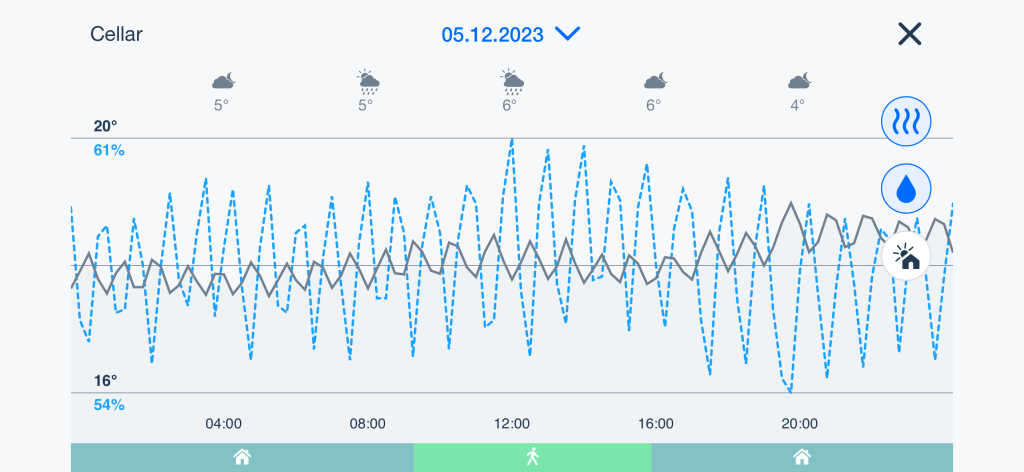

Posts: 4022
Be warned that running a dessicant dehumidifier for a significant amount of time can get expensive.
We use a meaco dd8l and I can clearly spot the month we bought it from the electricity bills.
At current electricity it costs around £4 to run for 24 hours, so £120/month.
This comment scared me enough to prompt me cough up £7 for a usage monitor plug to work out how much mine was costing me.
Mine is a Pro Breeze Desiccant model. It is on all of the time in my cellar with a continuous drain, set to target a humidity level of 55%, to achieve that is seems to run about half the time.
Anyway, after a day of use it has gobbled up 3.12 kWh. On my Octopus Go tariff I work that out as being £0.77 per day, £23.46 per month.
Temp/humidity graph in my cellar from yesterday. You can see it 's on/off in roughly equal amounts, which is typical.
cellar
Posted : 06/12/2023 2:46 pm
