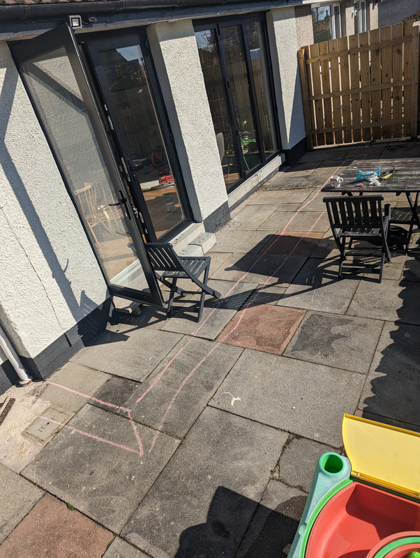

I am going to be building a decking step/platform outside my newly(ish) installed back doors.
See attached - it's going to be approx. 4.8 x 1.0m.
My main question is how do I attach this to the house? Unfortunately the door cills are not flush with the exterior walls of the house so a long joist screwed on to make a ledger board isn't going to work easily. Do I make the deck a complete standalone rectangular frame and then attach that directly to the concrete door cill protruding out? I can also attach it to the house and longer recessed door cill using spacers/packers I guess.
I plan to raise it to 250mm using posts sitting directly on the existing paved patio area. Should these have anything underneath them to keep the wood off the ground?
To lay the deck boards length ways, I was going to use two long joists length ways and then several joists width ways. I assume noggins in the middle length ways will help with strength here. I've not yet considered how many posts I will need or their placement.
Any advice would be greatly appreciated! Thanks.

My issue with attaching to the house is due to the door cills not being flush with the wall. One is protruding a bit and one is recessed a bit so I don't have a straight run to attach a ledger board. That's why I am thinking I should maybe build a standalone raised deck and attach it to the house at a couple of points.
I might lift up a few slabs that aren't needed and put the posts on top of them to keep them out of any pooling water.

You should consider where run off and splash back of rain will go. If you were building a raised patio the guidance is that the patio should be 150mm below the DPC and run off away from the building (obviously)
https://www.pavingexpert.com/dpc01
I don't see any reason why this doesn't also apply to decking. Overall the guidance for decking in the UK is poor. Our deck is spaced about 200mm, maybe more, from the wall. It's a white rendered wall and there's no sign of rain splashing back on it (usually there's a tide mark of dirt)
Your joist spacing of 400mm should mean it's solid underfoot. That's what I settled on for mine after looking into it (also found out 600mm spacing is nonsense)
Edit: now seeing your picture, the section of wall that might be affected by splash back is small, the doors won't have the same concern

I get what everyone is saying regarding the narrow width. We need a step as there is currently not one yet since the doors went in (they were previously windows). Minimum depth has to be 900mm I think for going in and out a door. I thought a decking platform would make a nice alternative to a concrete step and would look better if it stretched across the both sets of doors. It would be used as a step rather than a platform for sitting on.
I will discuss with the wife to make sure she would prefer a decking step rather than some sort of concrete/stone. I think I would have to get a builder in to do a stone step as it appears more difficult to me than cutting some wood. I could be wrong though!

Looks like you've got the start of a stone based step with those blocks on their sides under the single door. Could you bed a set of them onto the patio over the area you want to cover and top with pavers?

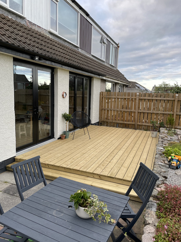

An update. I took some of your advice and ditched the stupid initial idea of a 1m wide decking platform to form a back step. I suggested stone steps as the best (most cost effective) option but was outvoted 1 to 1! We wanted the outside space to have the same floor level as the inside so decided just to deck the whole area outside the back doors. Really happy with how it has turned out. Hopefully with a bit of care it's going to last a decent amount of time!

Looks good
Posted : 25/07/2023 11:13 am
Posts: 3080
Looks really nice!
Is it me, or have you put the decking boards "upside down", i.e. with the grooves on the bottom? I presume that was deliberate?

Is it me, or have you put the decking boards “upside down”, i.e. with the grooves on the bottom?
I'd argue I've laid them the correct way! It seems to be a rather long debate across the interweb. We wanted a smooth finish and this also ensures we don't have grooves filling with water and dirt.
Posted : 25/07/2023 1:20 pm
Posts: 3080
I didn't realise it was so controversial! I can see why you'd do it that way, it looks better and I'm not sure if the grooves actually help with grip.
Posted : 25/07/2023 1:44 pm
We laid our decking that way around to match the finish of the planed wood fencing that surrounds it.
Posted : 25/07/2023 1:51 pm
Posts: 3315
If you're walking at right angles to the grooves, I find they give grip but can be slippy walking along them.  Ok for a walkway where you'd be going in one direction, but on a deck you can be going across & along.   You can buy grip strips to put in grooves but gets quite ££ even when only putting the strips every 5th or 6th groove.
