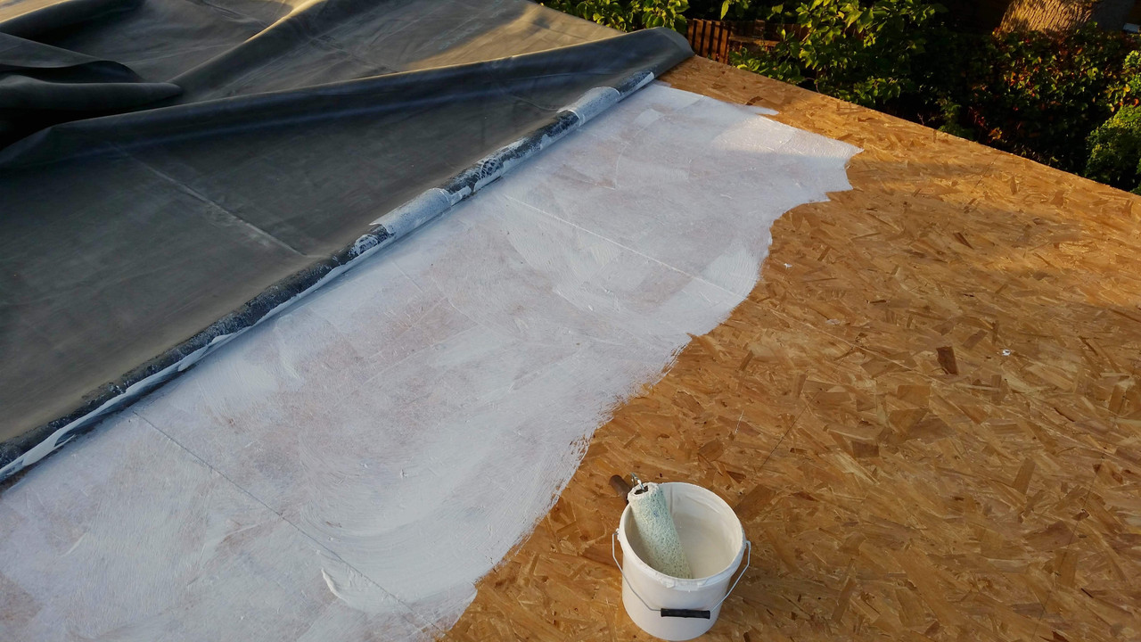

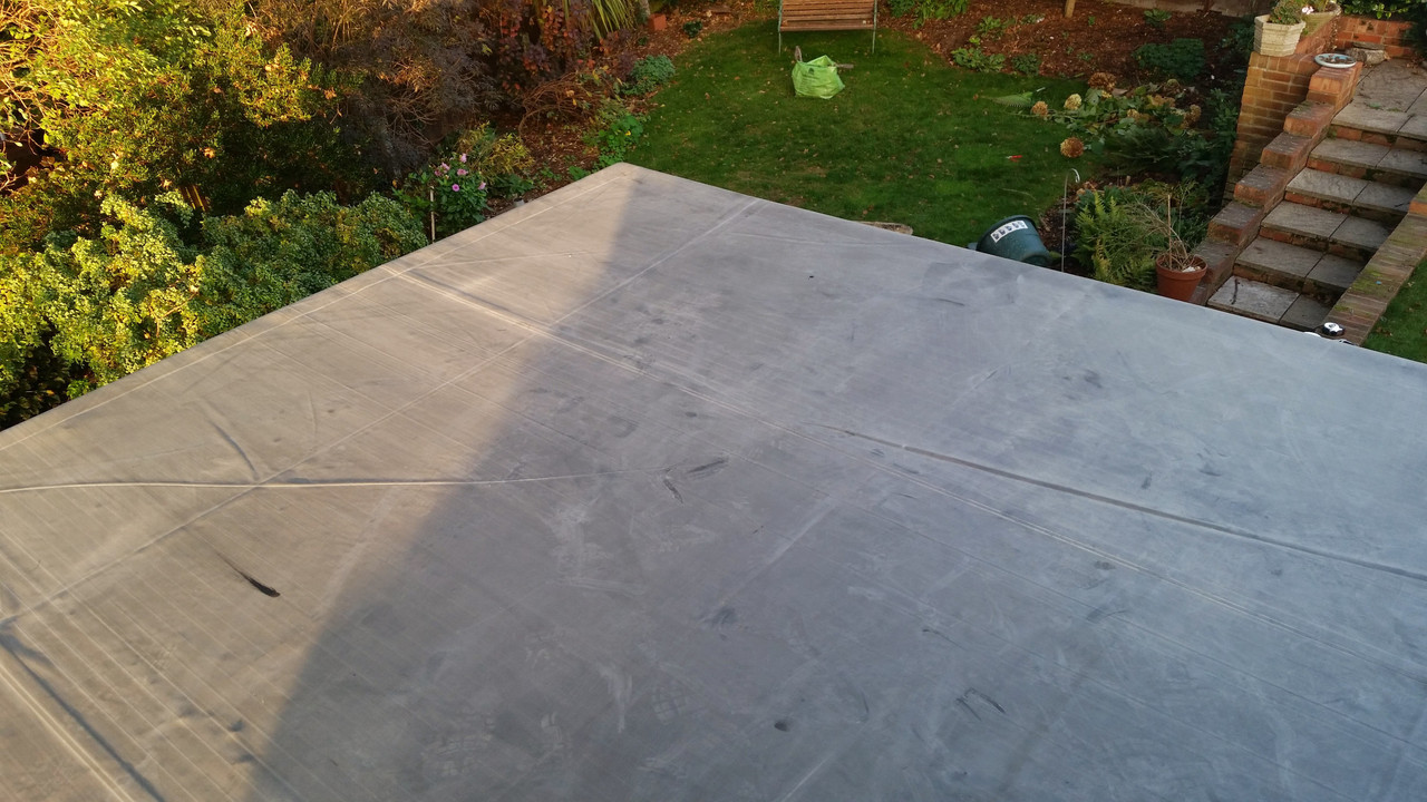

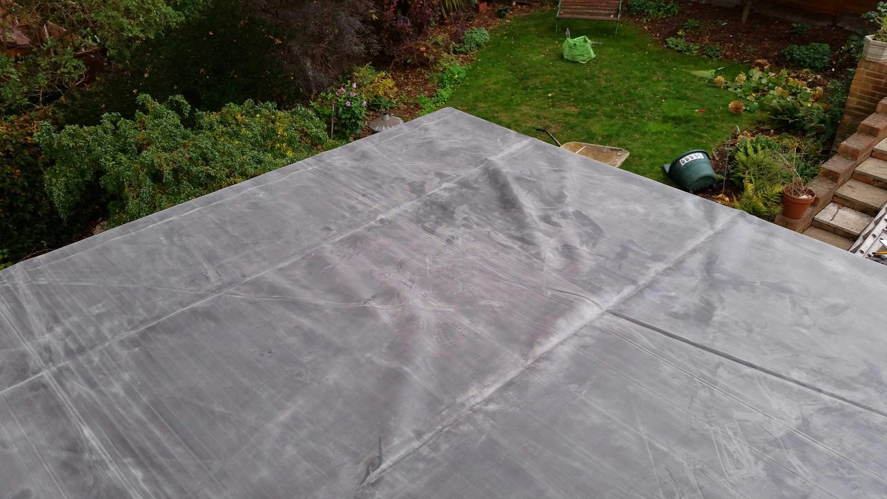

Step 1 Lay out the rubber to un crease
Step 2 Roll it back and glue it to the roof
Step three brush it down against the glue to remove as many creases and bubbles as you can
EDPM rested on the roof one day and fully fitted the next
Posted : 13/10/2020 5:00 pm
