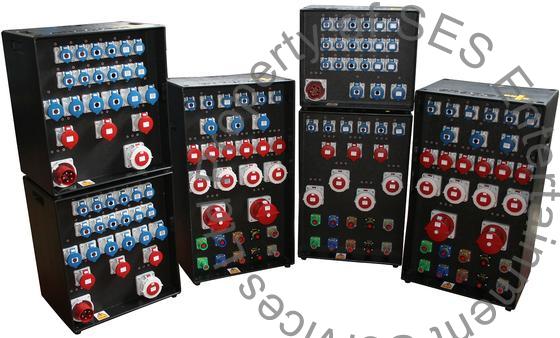

Posts: 7887
I'd start by getting a live distro sorted
I think we just lost the OP...
Hint - it's not:
[img] ?itok=enfS8TLj[/img]
Posted : 13/06/2014 9:34 am
