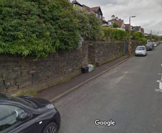

That looks like a really narrow pavement. Maybe try to get it widened so that door mirrors aren't making it difficult to get past? Do you fold your mirrors in when parked?

It's not that narrow, pic is foreshortening it a bit I think - 2 people can walk side by side easily enough.  Mirrors are generally folded in yes.  I don't think it's accidental if that's what you're getting at.  There's been scratches and a broken window too (I'm making it sound like a terrible place to live!)
