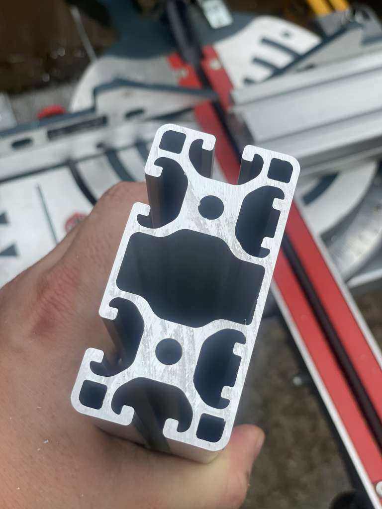

Posts: 906
I cut up a bunch of fairly chunky profile for a project recently using a Bosch aluminium blade. Made some lovely clean cuts that were probably as good as the factory ends on the lengths I started with.

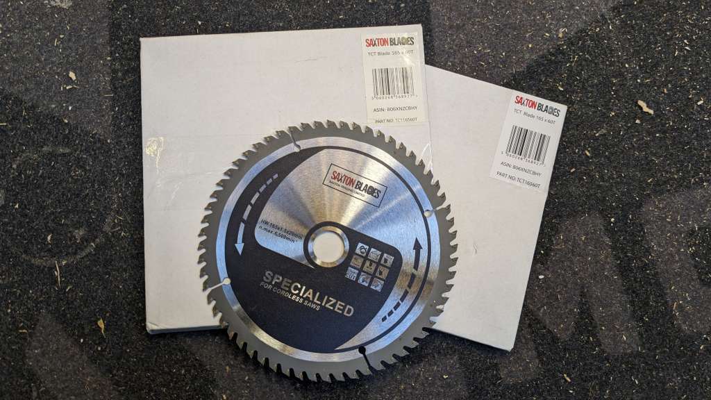

I use their tracky blades. Seem pretty good to me. Can't say I've particularly noticed them not lasting as long as the original Makita or anything.

Posted : 07/11/2023 8:59 am
